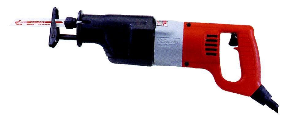

    Oh yeah they will fit fine Sawzall_febaab56fd6a35bbbb2a7d3fbd7d8b7475eb6b5d.jpg

    they will work if you tub the inner fenders and use that nifty tool Jlee posted to remove A LOT of metal.

    I honestly say go for it if that's what you want your going to have to tub the fender wells to fit them. my next set of tires will be 35x12.50's with a 3" lift and this will be my best friend.
