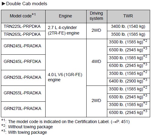

    The manual for my 2013 base (w/2.7) says the following for towing capacity:
    I'm not saying it would be an easy tow, as I do not have any personal experience. It does look like there is no SPEC difference between 4 & 6 unless you have a towing package.

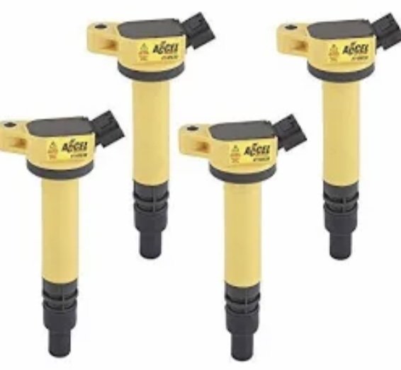

    Well, I’ll be talking about this literally non stop from now on since I became a believer but throw your weak oe ignition coils into the trash and buy quality replacements. You won’t regret it. I’d like to see someone try these and what they think382E37F0-99A5-441E-AC71-687CA530E896.jpg
