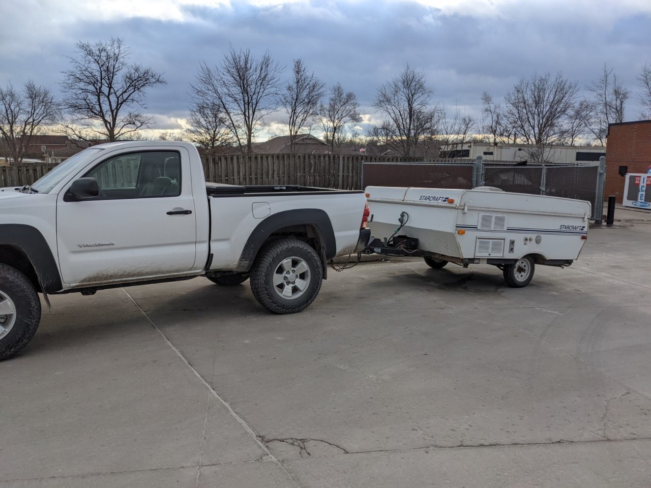

    I tow my pop up no problem with my 4 banger. Don't expect to win drag races with a trailer, be reasonable and it'll treat you right.
