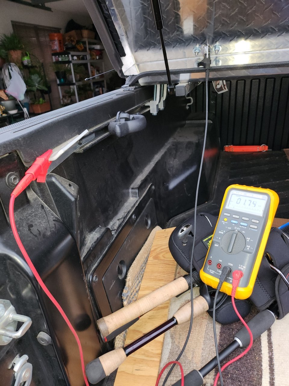

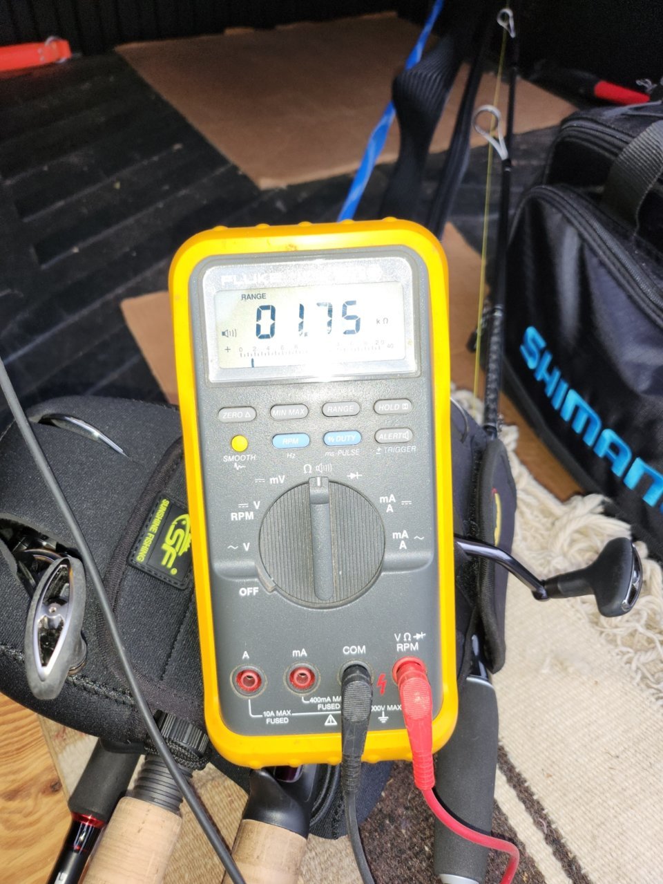

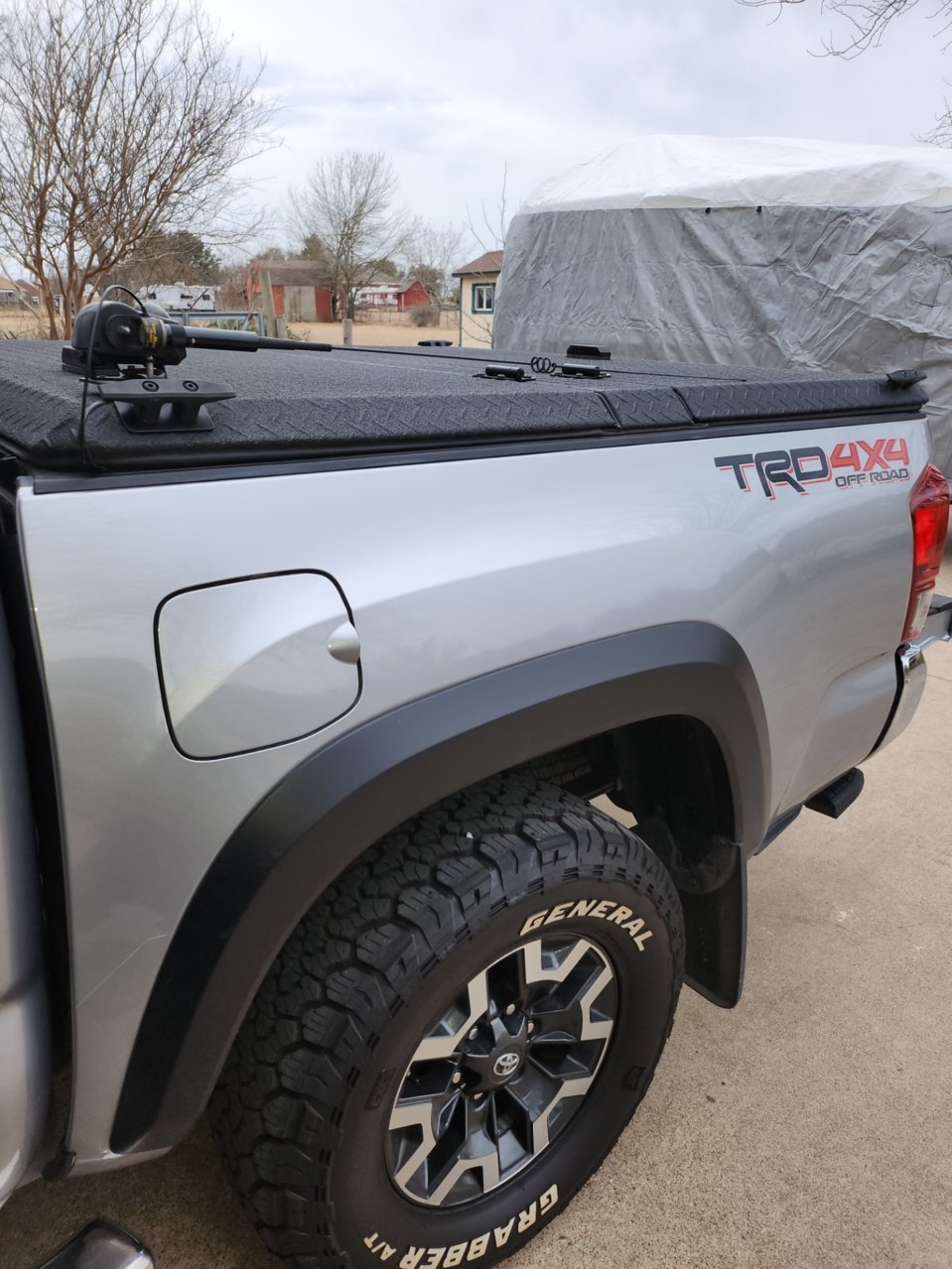

    well, their is a little continuity without big ole ground straps. But they certainly won't hurt. As far the an effective ground plane tying the three Diamond back pieces
    together would be best On my VHF/UHF antenna made by Diamond I believe, it is a radialess ground plane, basically doesn't require a ground plane. But you definetly will need one for 11 meters. They do make some really snazzy ones that can fold just haven't pursued that in years
