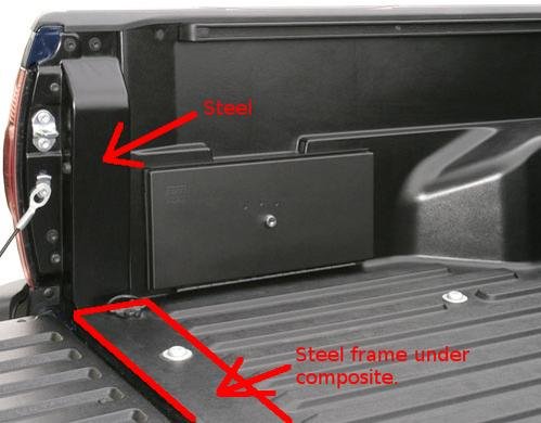

    The bed is mounted front, middle, and rear. If the rear mount point is bent DOWN, it will give your bed a "hump" and cause your panels to angle down. It isn't about damaging the side panels, but what they are mounted TO, which is the same brace as the back of the bed, which just happens to be attached to the rear most portion of the frame -- the part that got crumpled.
    It is **POSSIBLE** that the only damage to the frame is the rear most part. It is also possible that the whole thing twisted all the way up. Once it goes on the rack, you'll know either way.

    I'm pretty sure that the bed is made of run-of-the-mill fiberglass with a hard slick black surface layer. There are a couple of scratches in mine, and its white under the surface.
    Oh, the fuzzy-fan thing with fibrous composites is typically a result of a low resin-to-fiber ratio. I like to saturate my composites with resin. Weighs a bit more, but becomes insensitive to scratches. I would imagine that if you catch a scratch on a composite bike frame in time, you could just brush on some polyester resin and it will keep it from deteriorating any further.

    It's got at least some metal in it because you can ground electronics to the bed (at least you can in the area behind the tail lights).

    The composite is entirely non-conductive. There is no metal in it at all. Behind the tail lights, there is actually a steel frame, used to support the back of the body panel, tail gate latches, and sides of the composite bed. Under the rear most part of the bed where the tailgate contacts, is another metal frame. The rear cargo hoops are bolted into it.
