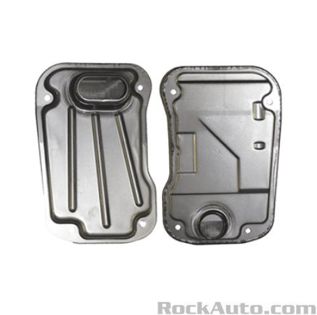

    What filter?
    Joel561[OP] likes this.

    Umm.....I'd use the transmission filter for the transmission in your specific truck. The filter isn't visible until you remove the pan.
    Oil, air or gas filter won't fit.
    Get onto RockAuto. Enter your year, make, model......the proper tranny filter can be found. Typically, the filter will include the pan gasket. Here you have a choice. Use the supplied pan gasket or use the gasket in a tube. Cost for filter/gasket <$15, then add shipping.
    As cautioned earlier, don't gorilla arm the pan bolts. They are small and don't need a lot of torque to seal the gasket.

    There IS no filter you fucking Pelican

    @Sharpish
    Thanks for the name calling.......very respectful.
    The automatic transmission most certainly does have a filter.
    See post #1 and #10, specifically the reference to the torque converter and automatic. Don't know many manual transmissions with a torque converter..............

    You replaced it, so tell me what it looks like?

    There’s no filter. It’s a sock that goes over the pickup. He’s giving advice about something he knows nothing about.

    @Sharpish
    Go onto RockAuto...... they have some nice pictures for you to view.
    BTW, the filter is inside the pan. Not visible until the pan is removed.
    Thanks Yukon..... :thumbsup: Thats a funny looking sock......:rofl::rofl:

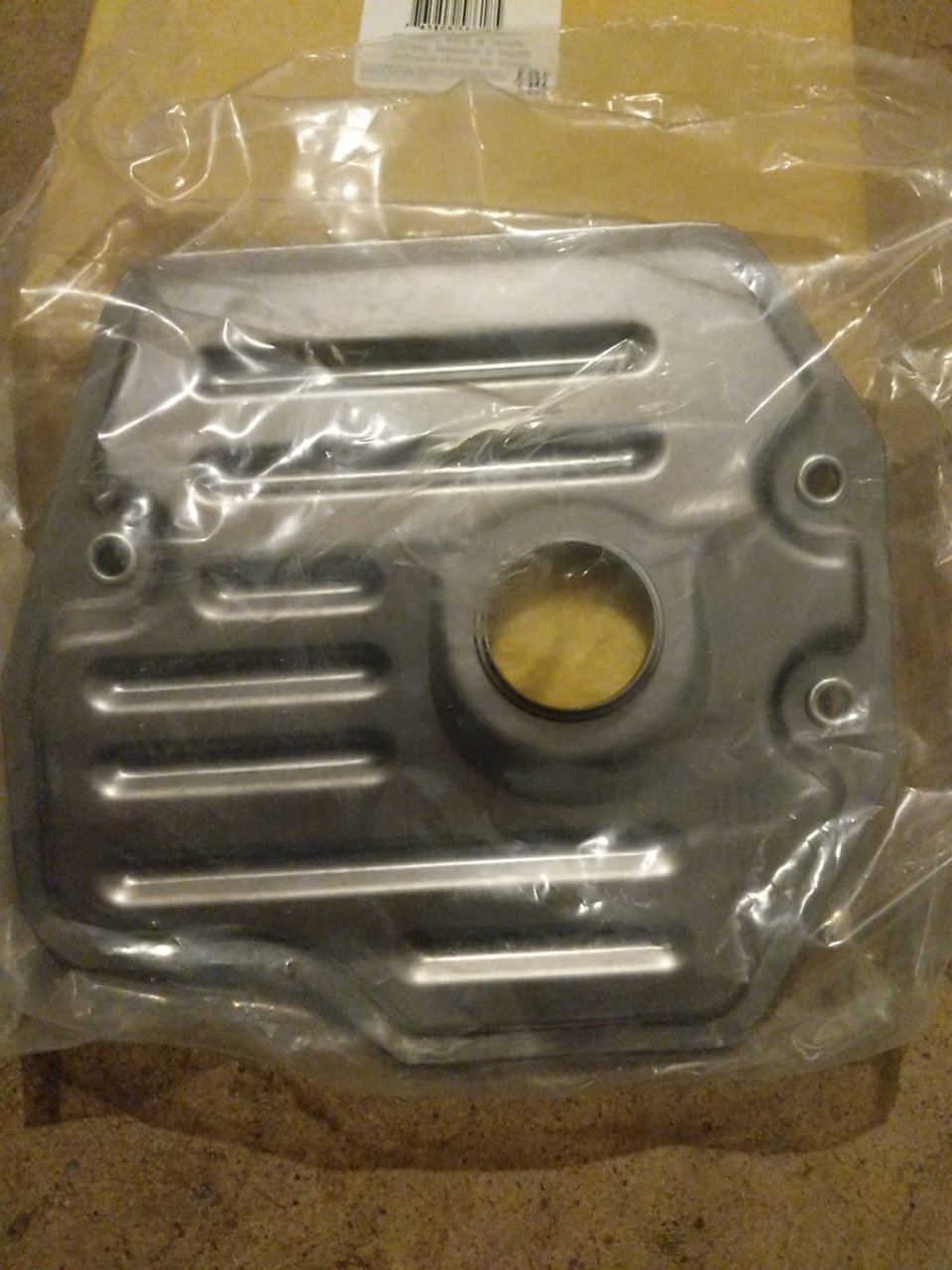

    My transmission filter looks like this:
    I'm a pelican too!
    By the way, I got my filter and fluid from Amazon, it was the lowest price I could find at that time.
