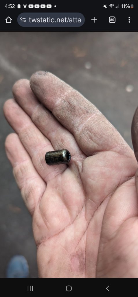

    I was taking off my air manifold and as I took it off this came out and can't find where this came from, would greatly appreciate any information on where this belongs.

    ACIS valve

    Thanks. Yes I saw a post where this has been a problem with others. Mine broke like the others. Now what I want to know is where I post to have this counted and hopefully is made as a recall. Thanks so much greatly appreciated. I'm praying that I don't have to but the whole manifold intake.

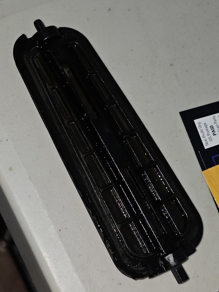

    Some here call it the flapper. It is the other parts, like what is showing in someones hand, that operate it that break
    You will be very lucky if nothing broke off and fell into the valves'
    Why did you take off your intake in the first place?

    Oh it is a definite safety issue. If the lose part when it occurs goes into the valves while in motion , that sounds like safety problems. The picture I'm including is what I'm talking about that can go into the valves. I've seen other posts where ppl say they have to repair the whole engine because of this fail. Thanks for the link.

    I was told that the symptoms I was having looks to be injectors and I have a injector cleaner machine. went ahead to remove it. To notice the flap come out from the intake. That lit a bulb of curiosity
