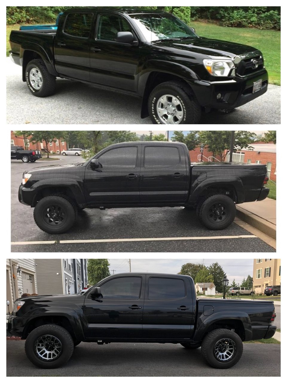

    Yep, no issues. As long as your bumper isn’t rusted out or anything, they should be able to color match it. The back of your bumper is coated in this rubber type stuff I guess to help stop rust? Idk but the powder coat shop scuffs up your bumper by spraying it with some type of media kind of like sand blasting to help the coating stick and then just powder coats it the color of your choice, and then a clear powder coat over that if you want it. The guy told me I didn’t need it and it would have been fine with out it but it was like 50 bucks more so I opted for it for just another layer of protection. It looks factory now. No one can tell it used to be chrome, but it’s much tougher than if you were to just get it painted. I believe it’s cheaper too, although I never got a quote from a paint shop. I don’t have any pictures on my phone of the back of my truck right now, I’ll take some later but you can kind of see the sides of the rear bumper in these prior to powder coating and after FADAF2B0-120B-4D74-B04F-4019E4D6E417.jpg

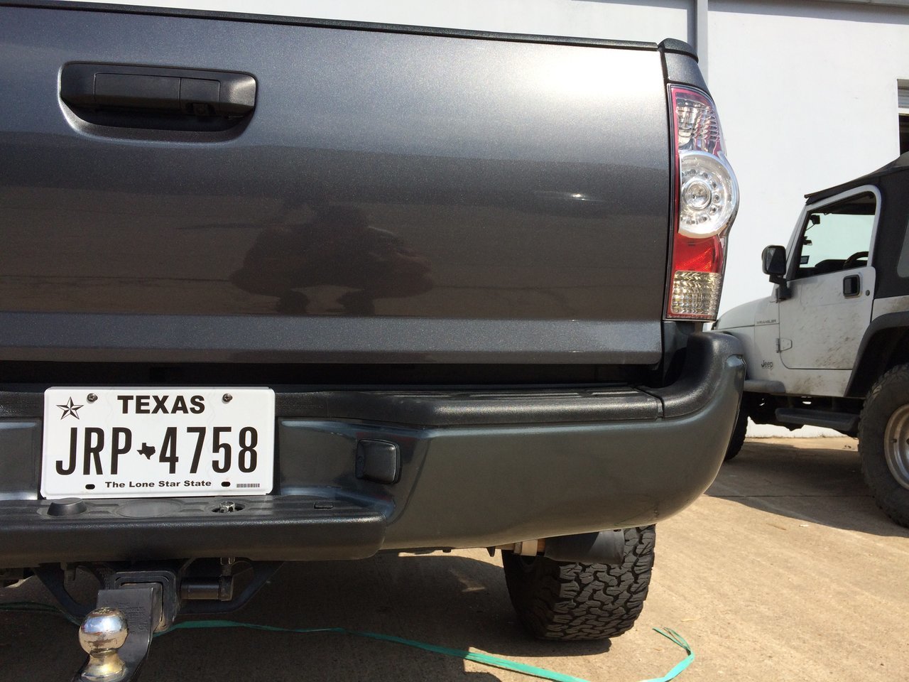

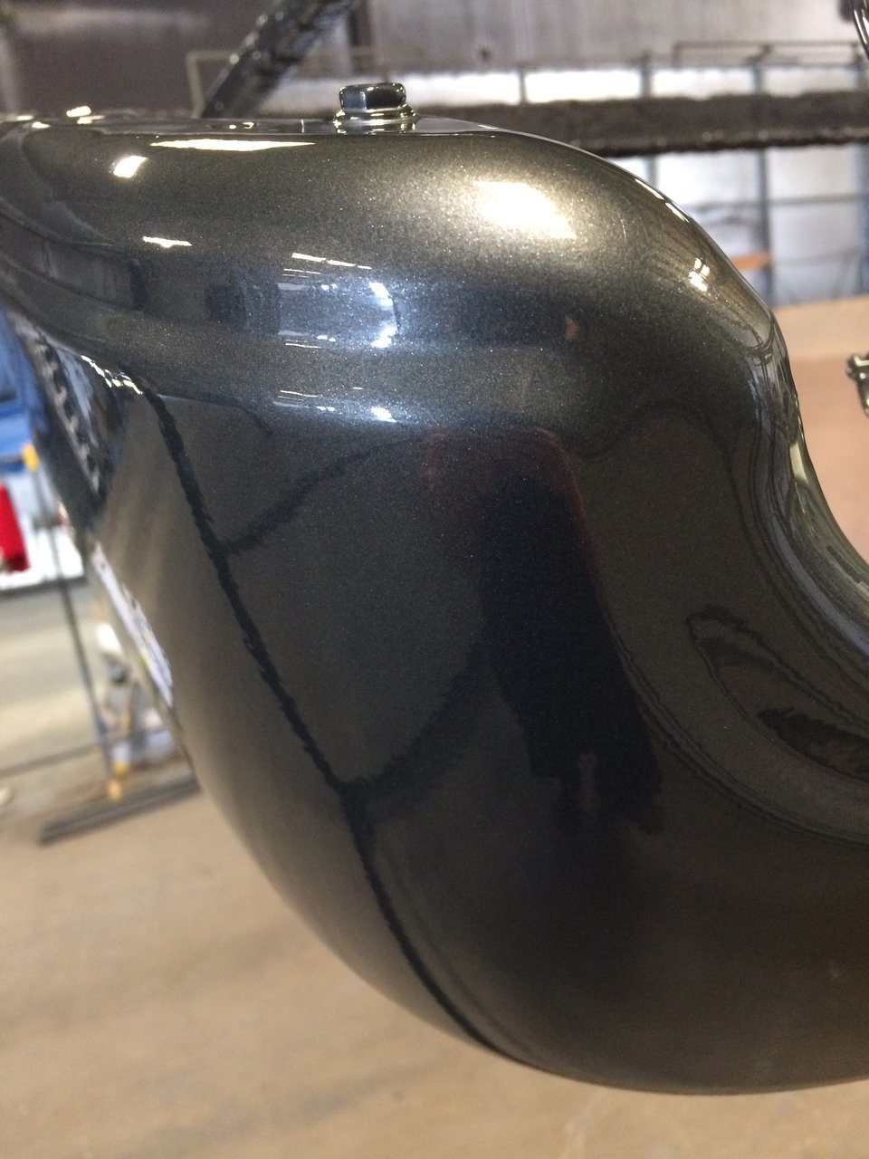

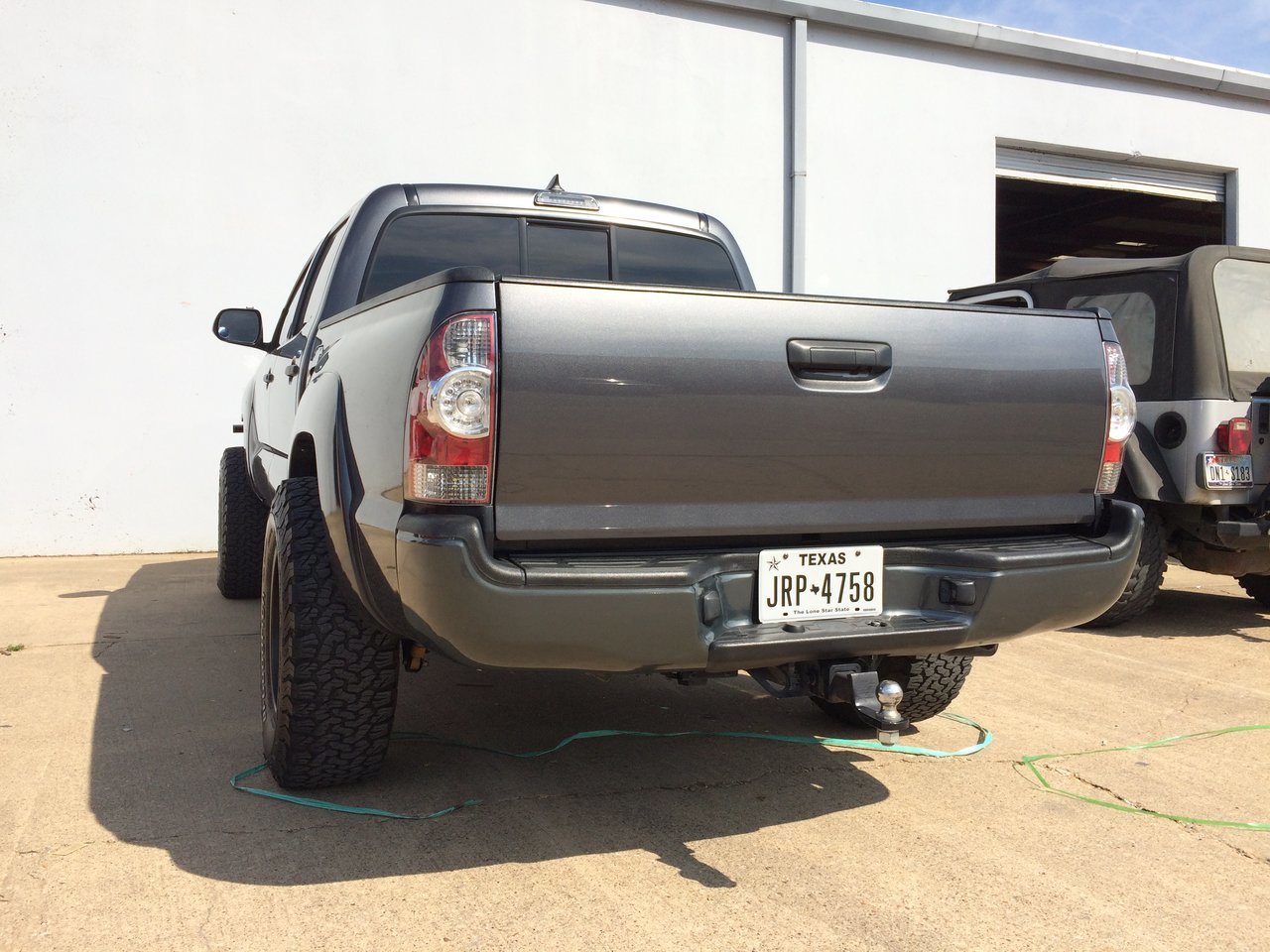

    Find a buddy that is a powder coater. Did mine for free with a metallic charcoal powder we had sitting on the shelf... pretty damn close match IMG_2923.jpgIMG_2924.jpg IMG_2925.jpg
    TacoJuan, Fitz235 and fshams[OP] like this.

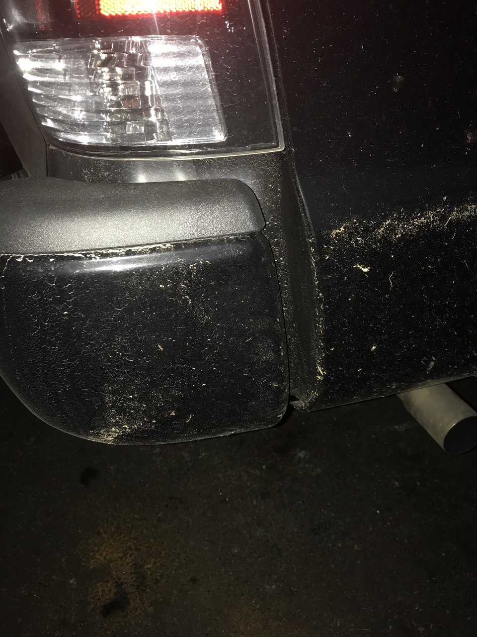

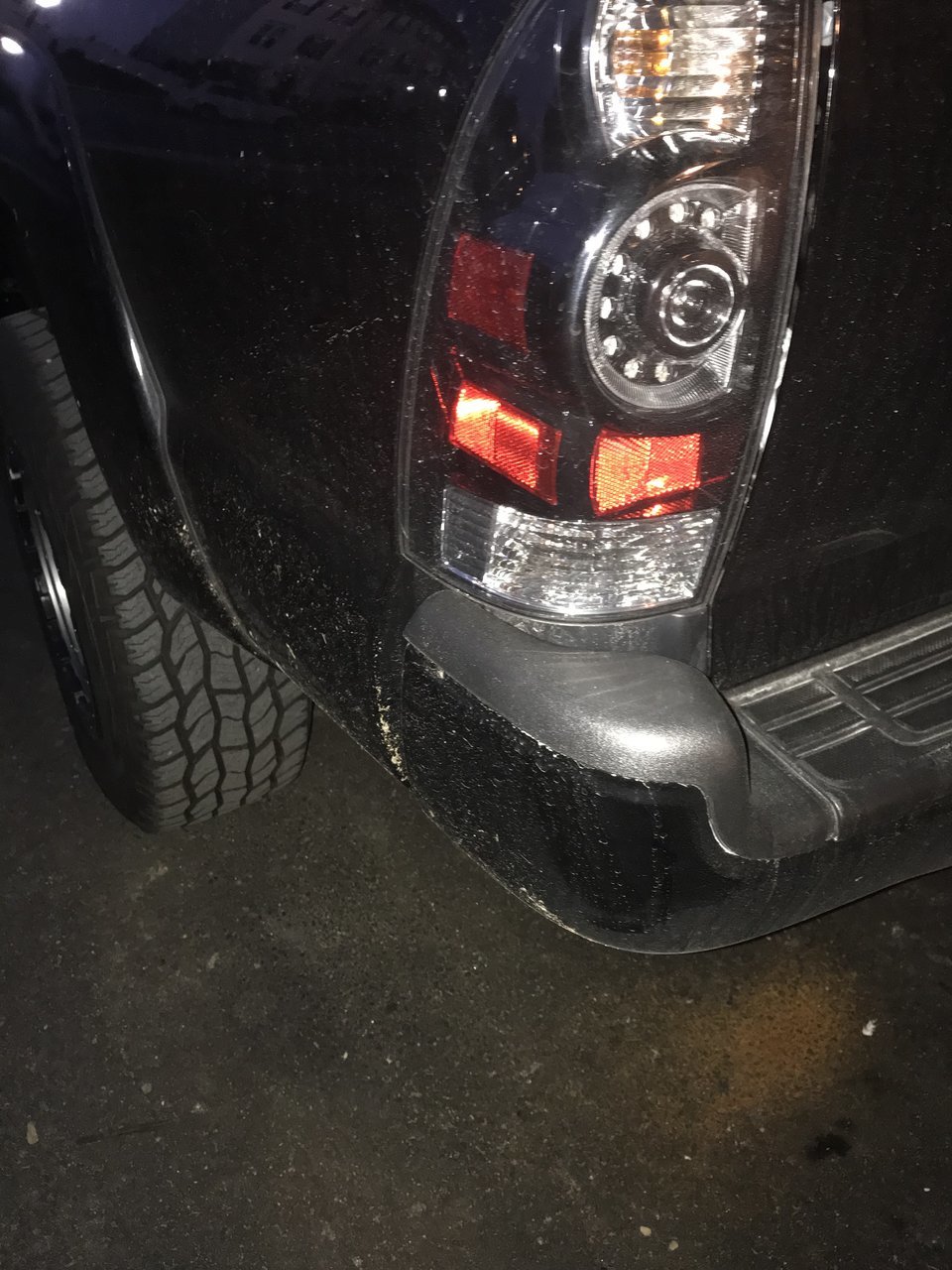

    I know these pictures suck, my truck is really dirty but I snapped a couple on my way to work. 92A012EF-94A0-4970-9454-DEAFBCE481FB.jpg23DEF364-23C4-466C-9C20-7E75A31EF636.jpg
