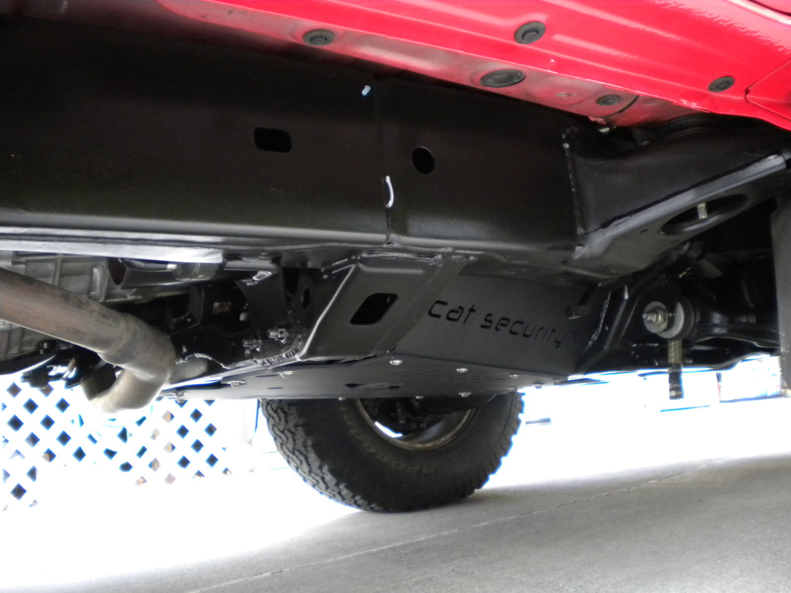

    I touched up with rust oleum around the welds, etc when mine was new 16 years ago... it's held up fine. Fluid film has been applied over it with no issues. Didn't spray the paint... used small brush and a can of matt black rust oleum.

    That looks like brand new. Yes I have the cans , just wanted to get it done before salt pours here in NJ
