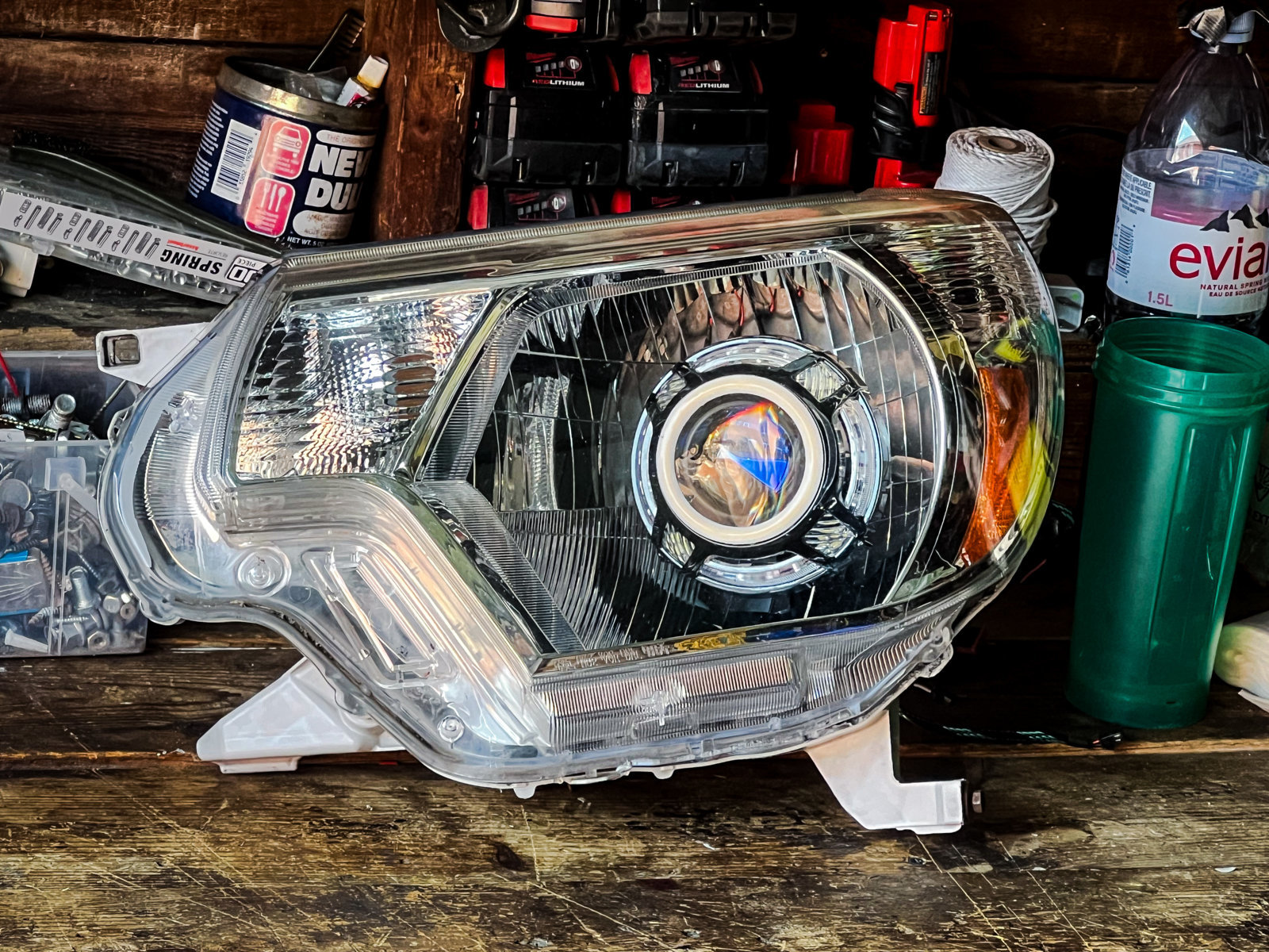

    Build a set of retros for almost half the price and double the performance.

    … not a big fan of the way the “eye” looks tho

    I’ve heard Morimoto is better than AlphaRex.
    It depends on what light emitting source is used. And what is able to be fit inside the housing.
    There are good projectors. There are bad ones. Another factor is the cost compared to a regular style housing with better bulbs and harness that is popular, an upgrade, and cheaper.
    the housing has a say. Every housing is a different shape. Some can fit a good projector. Some can’t.
    this is probably the way. Very common on other cars and many write ups on HID planet forum. Very affordable. Don’t know why this isn’t more common on the Tacoma. This is the only way to do it.
    I did something similar on my last car and it was the best lights I ever had, could see anything.
    Bosch AL gen2 bixenon e46 projectors
    TRS clear lens
    Paint black cutoff shield
    HID D1S osram CBI bulbs (green mercury free)
    I think either 35w or 55w ballasts
    TegoTaco[QUOTED] likes this.

    I’ll be running a Morimtoo D2S 5.0 projector along with a 50w ballast. :)
