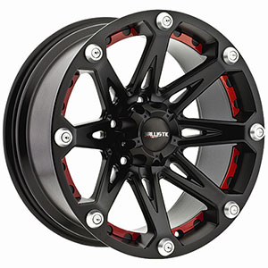

    Looking to buy some black wheels with a red lip for my Tacoma. I ran into these wheels.
    http://www.razewheels.com/product_6_1034.html
    They have 8 lugs so I was wondering if they would fit? If not what wheels could you recommend that are black with a red lip?
    All help would be appreciated. Thanks in advance.

    the only reason they have 8 lugs is because it is a universal wheel..... yes they will fit....I dunno what your offset is but that is gonna sit really far in..... I wouldn't recommend them because they have such a bad offset.... 42.....

    Get the Jesters with a 0 or -12 mm offset depending on what size you wanna run...I'm getting 18x9 with -12 mm which is 4.5" backspace and you should be fine.
