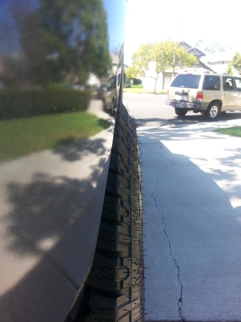

    This is how far a 17x9 wheel with -1 offset and 265/70/17 sticks out. Perfect IMO...a -12 offset would stick out 1/2 inch further.
  10. Dec 14, 2014 at 7:45 PM
    cmbondo
    cmbondo Well-Known Member
    Feb 2, 2014
    #122060
    564
    San Diego CA
    2021 Cement DCSB TRD Offroad
    FOX 2.5 DSC and some other stuff too.
    you are correct sir...my typo!

    You have any pics of your wheels on your taco?

  14. Dec 17, 2014 at 8:48 PM
    300AACTaco
    300AACTaco [OP] Well-Known Member
    Nov 30, 2014
    #143378
    2,646
    Alaska
    Black '15 DCSB TRD Off Road 4x4
    ARB Old Man Emu 90000s and 60091s OME 886s, Trim Packer, Icon Tubular Uniball UCAs, CMC, Invisible Sway Bar, Dakar Rear Leaf Packs, Timbren Rear Bumpstops, All Pro U-bolt flip up kit, Method Race Wheels NV 16X8 4.5BS, Cooper ST Maxx LT285/75/16, DEPO Black Tail Lights, Weathertech Floormats, Cascadia Vehicle Tents Mt. Shasta in Earth Tone Green, Custom Green Tree Fabrication Bed Rack, N-Fab Spare Tire Bed Mount
    That looks amazing. About to order mine right now. Just wanted an idea of how far the wheels and tires stick out. That looks perfect in my opinion. Great looking truck

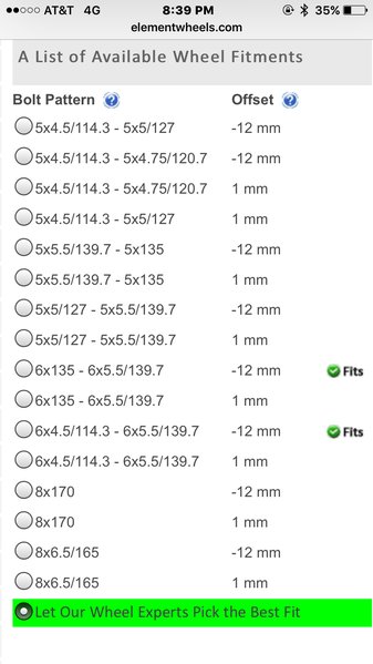

    @cmbondo which do you think would work best with -12 offset

    Only 1 lug pattern will work. The Tacoma's is 6x5.5 inches, or 6x139 mm (inches converted to mm).
    The question you should be asking is which will fit better? The -12 mm offset, or 1 mm offset.
    The pic he posted above is essentially the same as a 1 mm offset. The wheels will stick out a half inch further with a -12 mm offset.
  17. Jun 2, 2016 at 5:03 PM
    #17
    cmbondo
    Feb 2, 2014
    #122060
    564
    San Diego CA
    What he said...
