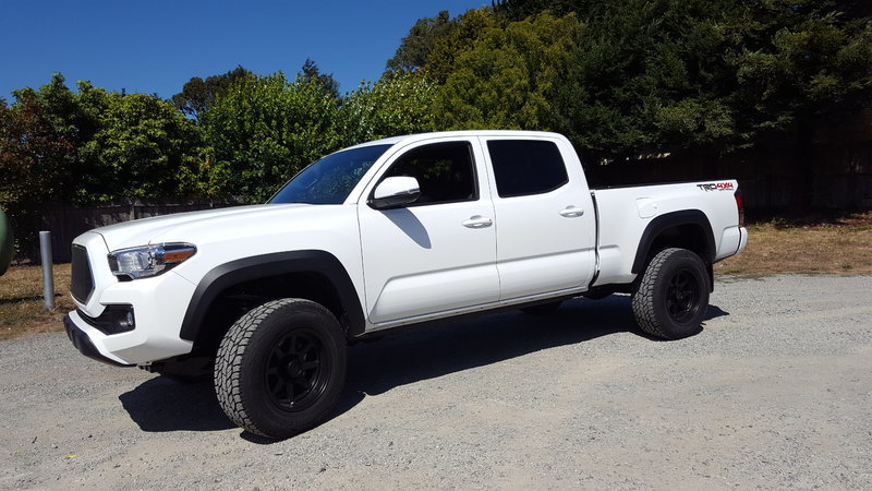

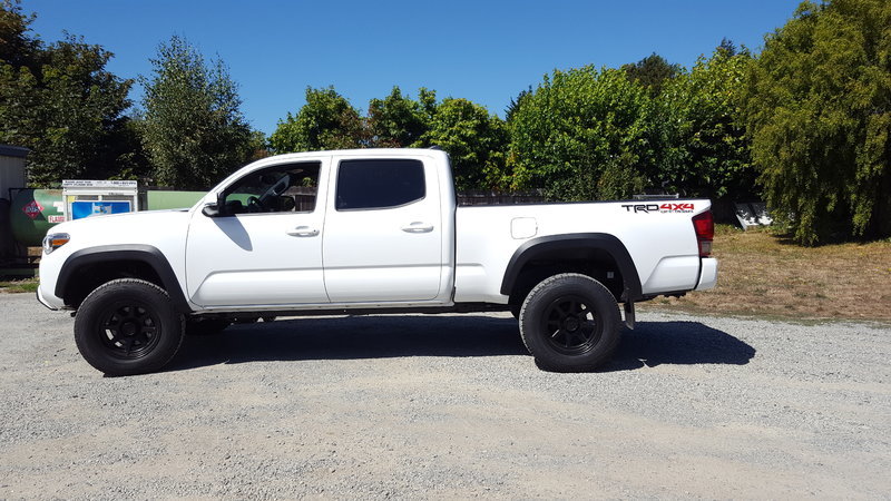

    Bought new wheels and tires and the "tire pros" at the local tire shop didn't inform me that too much offset on the wheels would rub. Now I've got great looking wheels and tires but at full turn they rub on the metal frame (known as the Cab Mount).
    Would it be wise to just get 1.25" wheel spacers or have the local fabrication boys CMC my brand new gen 3 :bananadead:? I could always take the wheels off and sell them but I am pressed for funds right now and would rather not go through the trouble of having to sell them and buy new ones.
    Wheel spacers could be around $250 bucks where as having the fab boys chop into my frame could be $$$$$$ more costly. Not sure what to do. 20160809_153201[1].jpg 20160809_153219[1].jpg

    Usually don't need a CMC for 265s, but if necessary you can get a CMC for a c-note or so , it's less than an hour, less if you chop it yourself then bring it in to have the plates tacked in, plates available from BAMF or can have the welder cut some for you. If you want to run 285s the CMC is a necessity 90% of the time. Doesnt affect the appearance of the truck . Spacers generally are to get tire off the UCAs or for appearance

    I looked at the spot where it would be cut and it looks like it is already pretty flat. When you cut, are you just taking out about 2 inches back and then welding it straight again or is it supposed to be contoured with the tire? I used the seach button looking for gen 3 pictures of cut cab mounts but no luck yet.
