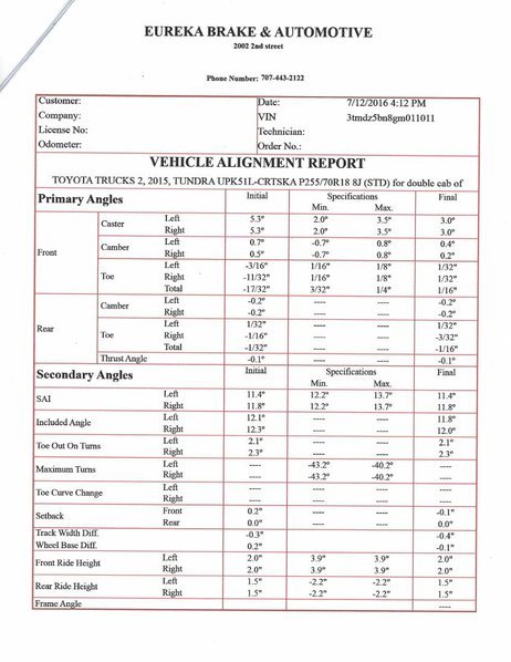

    Hope that is readable. I don't really know how to read these. Does this indicate there may be a chance to adjust the caster?

    Your min max specs are all wrong for your truck. They are for the Tundra.
    That said, the caster @ 3.0 is OK. The stock increments for caster is 1.0 ~ 2.7. More caster means less chance of rubbing on the cab mount.
    Technically for optimum alignment, you want your toe and camber to be at 0, but you're close enough and still within (Tacoma) specs.
    Are you 100% sure that the wheels are -12mm offset versions? Tire rack shows your wheels with another version at -18mm offset. It's usually stamped inside the wheel.
    IMO, if you're getting tire contact with cab mount at 85% lock, I would remove those wheels immediately. I would not feel safe driving it.

    Where was the alignment done
  14. Aug 10, 2016 at 12:52 PM
    #54
    stan23
    stan23 Well-Known Member
    Jun 20, 2014
    #132351
    2,449
    stan
    Santa Clara, CA
    2025 DCSB TRD Sport 4x4
    Did you see the screen shot posted above? Looks like it was done at 'Eureka Brake and Automotive'
