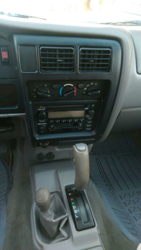

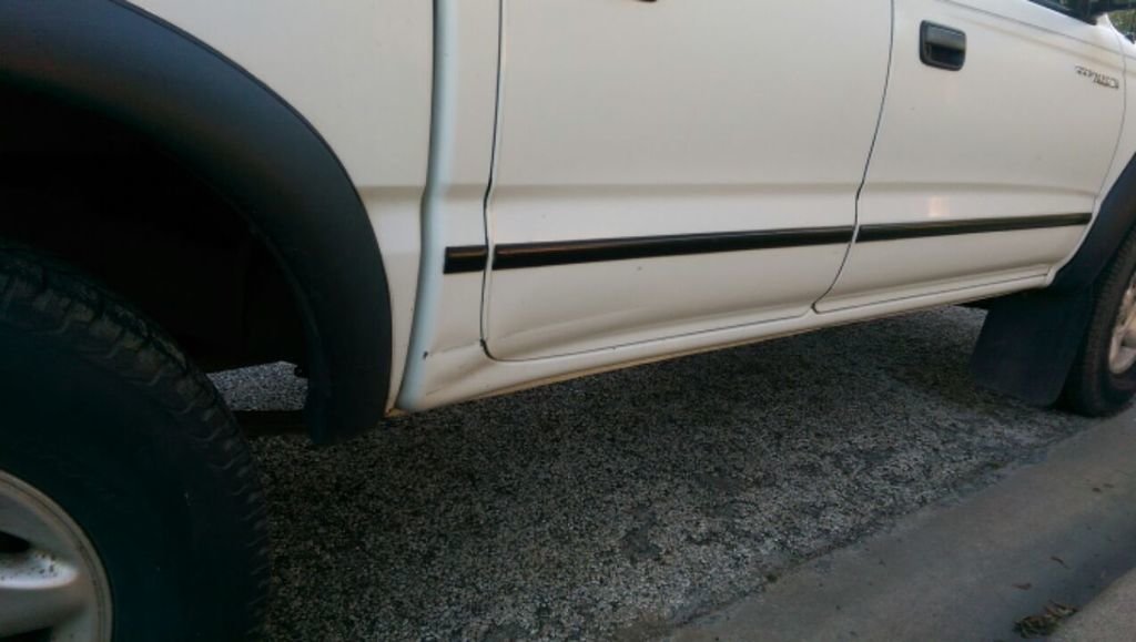

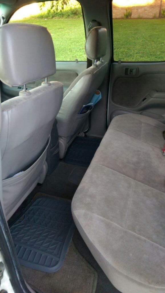

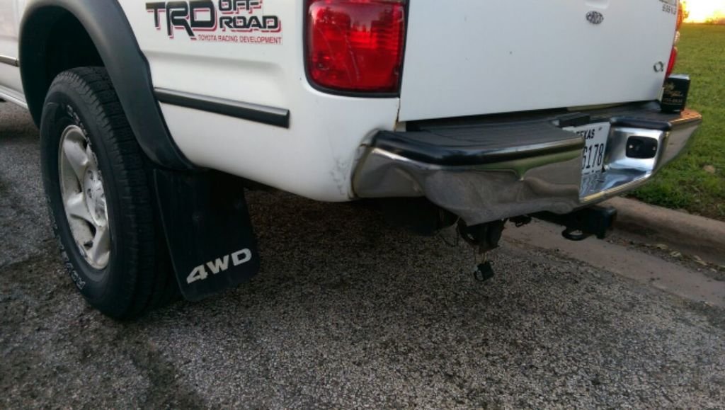

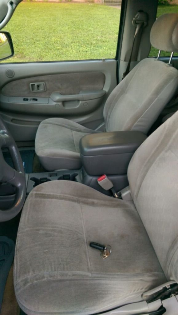

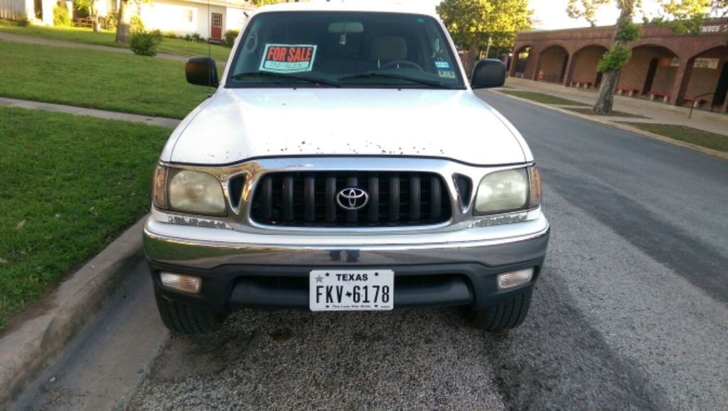

    Hey guys I am bumping this thread because I am also looking at buying a 2004 Double Cab 4x4 TRD with 199k miles. The person selling it is the original owner and has a binder full of maintenance records. It has always been a Texas truck so I don't have to worry about rust but the body of the truck is not in the best shape. There is a dent in the rear bumper on the driver side and it looks like it needs a new grille, head lights, and hood with grille inserts under the head lights need to be repainted. The truck bluebooks for $10k in fair condition but they said they would take $9 for the truck. It seems like double cabs have consistently gone up in price each year and now it seems impossible to find a good deal or one with low miles for a decent price. Let me know what you guys think if I should go for it or pass. Here are some pictures of the truck.

    How much is the asking for it with 220K miles? I am the original owner of a 2004 Tacoma with 243,600k miles and it runs great but at this mileage you will begining to replace a lot of things like shocks,02 sensors,exhaust systems and maybe starters,universal joints Depending on how well the previous owner took care of the general maintainence would be a big factor. If the person has all oil changes and regular repair work documented I personally wouldn't go any higher than $6000-$6500(that's with maintainence documentation). For use as a second vehicle for be a perfect buy in my opinion and you could do any maintainence issues yourself and save quite a lot of money.

    That part of the thread is old. I was asking about the 199k miles tacoma that I am looking. I highly doubt you will every find a double cab tacoma for $6500 let alone a 4x4. I see ext cabs with 350k miles that they people are still asking $7500 and up.
