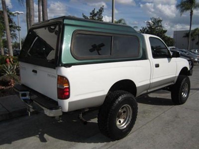

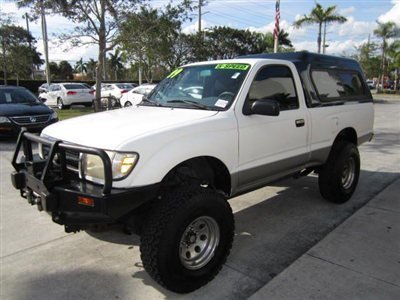

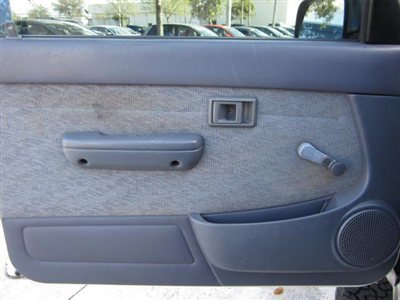

    Updated pics after they washed it up.
    If you catch any red flags, speak up. :)
    Thanks, all!

    Just some casual observations:

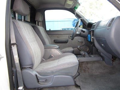

    Lots of rust coloring in the interior. Possibly water damage? I assume the car-fax would show that if it did.

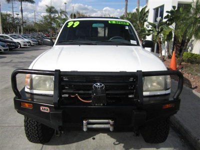

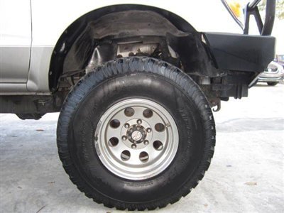

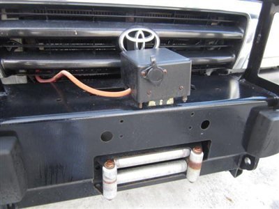

    The front is a bit higher than the rear, even with that bumper and winch. With those 2 items gone, it will be even higher. You'll definitely want to remove the lift in front (fairly easy job, with an Autozone-free-rental spring compressor), but you'll need to score stock springs for it. Not enough detail in the photos, but I assume the lift is just the spring, and not something weird.

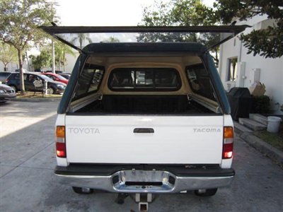

    Hate that shell :(

    Single cab plus its manual trans (which I like). Those two factors can add up to a bargain deal for someone looking for those.
    There's a reason you don't find that many manuals (or all that many single cabs for that matter) these days. Most new truck buyers aren't demanding those anymore.

    Yes the shell is going, likely the bumper as well unless I like it in person. So that means the lift as well, which I'm sure I can trade with someone.
    As for the stains I was hoping that was coffee. Wishful thinking, hah! Carfax shows no flood damage so that's likely just wheeling water. Yikes if that's the case.

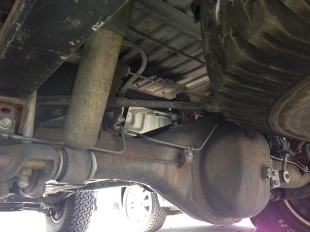

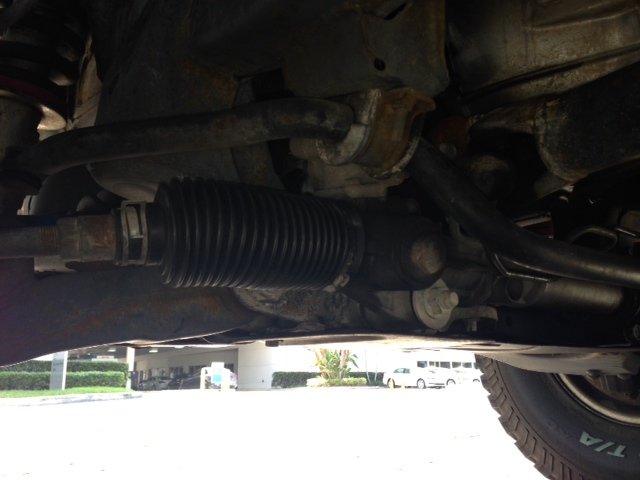

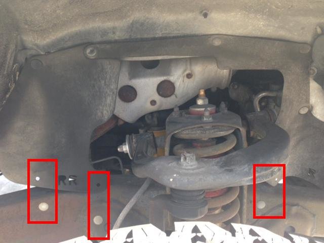

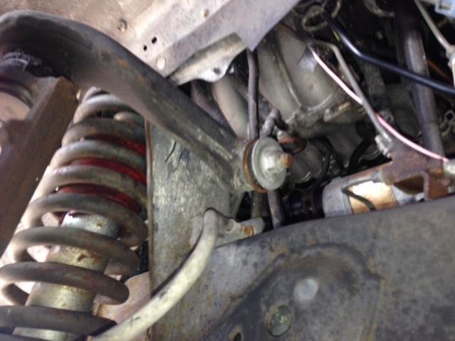

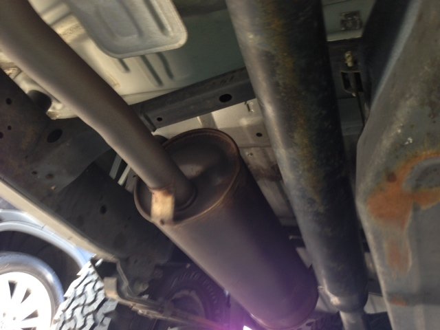

    Some underside shots. Frame looking ok?

    It also has slotted and drilled brakes which is a great plus because these aren't known to brake well as well as being known to warp stock rotors
    A bit of surface rust that you would probably want to clean up
    Otherwise looks like if you sold parts you could end up with a 1000 bucks worth of parts for sale.. Maybe

    I am assuming you have never been to south Florida? Lol. There are a LOT of great wheeling places there including sand dunes, as well as some BIG mud holes and the like. Lots of fun!

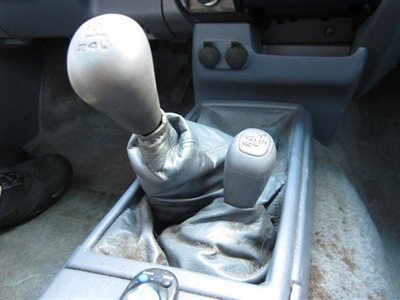

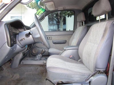

    From all of the pictures I only see typical surface rust, not uncommon for being in the salt air. The only "flag" I see is shown from the interior pictures. Looking at the shifter I can tell that there is most likely a 2 inch body lift, which is not very desirable of a lift to have. However since you don't plan to wheel with it, that shouldn't be a concern.

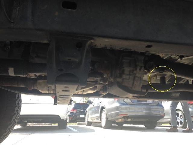

    Hmm... Is that a lift block in this pic?

    Looks like a body lift. My old 98 had one put on by the PO and it had the same gaps under the rubber flaps in the front wheel wells and my aftermarket hitch also sat a few inches under the bumper.

    Oh, yah... def body lift. I see the gaps now. And the bumper is low, yes.
    Paint is also confirmed to be pure chalk. I think I'm going to take a pass on this one. Too many things to reverse/fix and I don't even need a 4x4. Plus the salesman isn't moving on price at all.

    You are welcome! lmfao. Just kidding. I knew something was off as soon as I saw the shifter.
