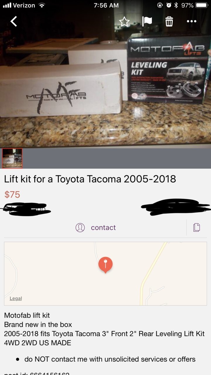

    There’s a guy on Craigslist selling a motofab leveling kit for $75 and I thought it might be worth a shot.
    I’m sorry this is another lift kit thread in advance. Using the search function I have definitely ruled out an RC lift kit (even though $280 is intriguing) and am looking more so in the price range of $1000-$1500 for Bilstein 5100s with UCA’s, OME or Toytec.
    So my main question is, can a leveling kit be a temporary solution if you strictly want the truck to be lifted for the looks, and does it sacrifice any of the trucks reliability or void any kind of warranty?

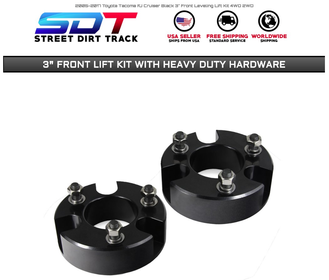

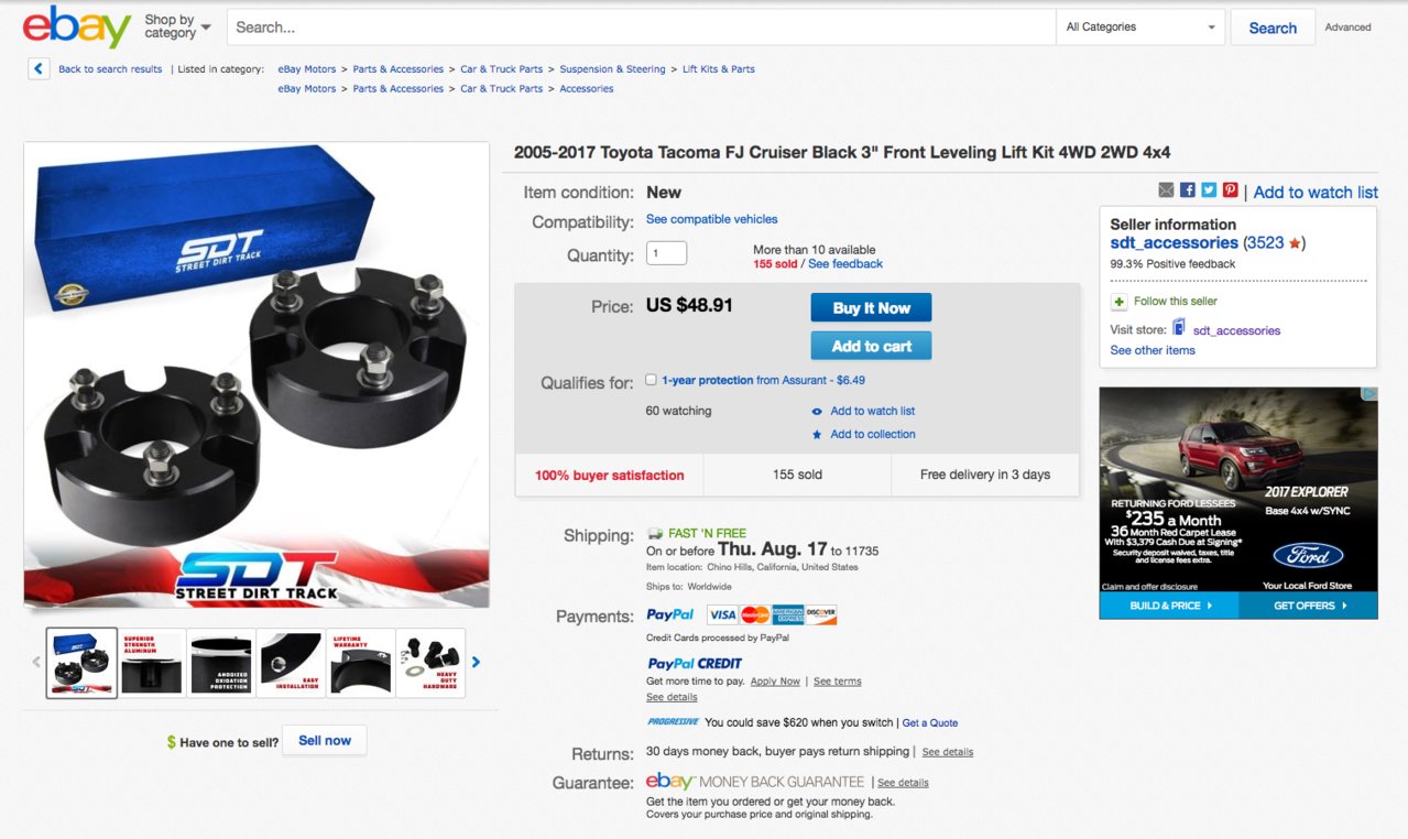

    I think this type of leveling kit would do exactly what you want, superficial and don’t plan to off-road.
    Lifting your truck around 3” to run a little larger tire.
    The things you must look out for alignment issues, and Topping out the upper control arms when you get over the 3 inch range.
    I had a 3'' leveling kit in my 2013 reg cab tacoma and it was fine.
