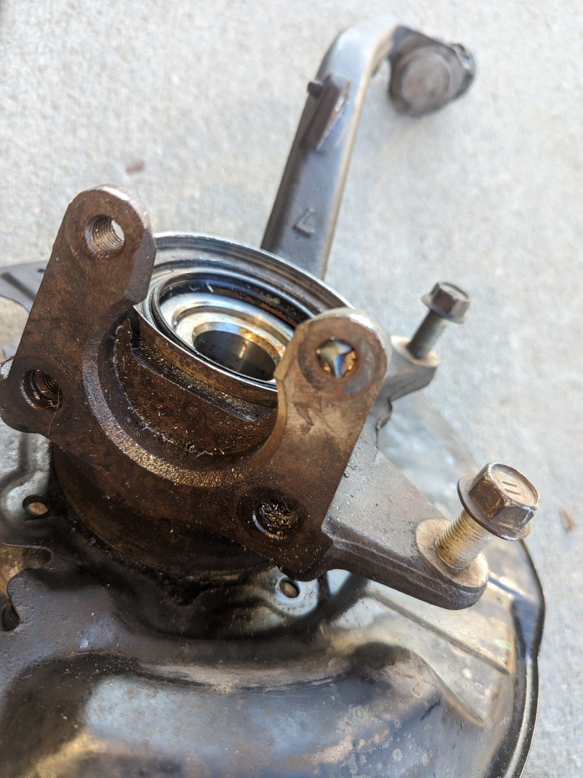

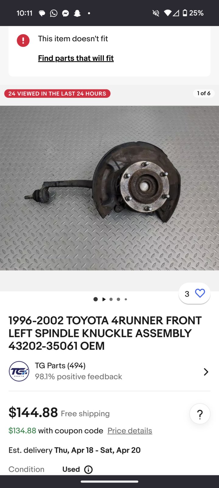

    So my trucks steering knuckle has 2 bolts that were snapped off inside where the LBJ connects to the knuckle. I order a new knuckle off Amazon but it has no wheel hub, and come to find out it's quite the job pressing out or installing a new wheel hub into a knuckle. So I'm going to either try and get the snapped bolts out without destroying the threads or maybe buy this guy. This part should fit on a 4WD 1998 Tacoma yes?

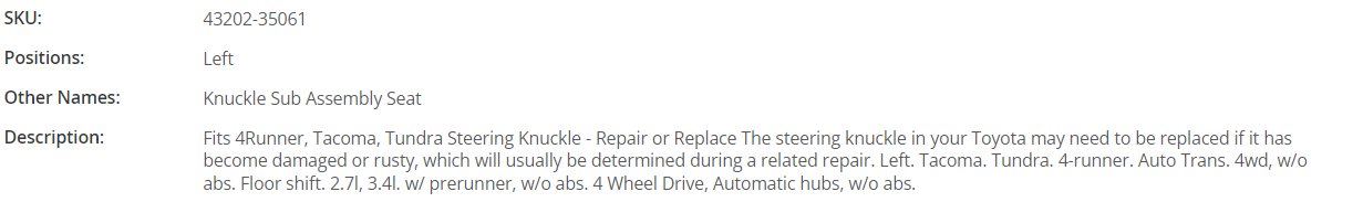

    Did you try car-part.com and check your local area for a steering knuckle? Might be cheaper. If you decide to go with that seller, make sure they offer some kind of warranty in case the hub/bearing is DOA since you can't inspect it.
    As long as the part they are selling matches the part number they listed (43202-35061) then it will fit your Tacoma.

    The knuckle, yes, but the hub is for 2WD and not 4WD. This won’t work for you.

    Yeah wouldn't be too difficult if I had the proper press, I'm not sure which shop around me would rent out a shop press though, I usually always rent out suspension and drive tools just from autozone. But it's definitely worth a check. I've done just about everything on my truck besides a new motor so I'd definitely try out replacing the bearing. But I'm gonna try to drill out the broken bolts and use the existing parts. My damn bearing did get a little seized up after sitting for so long though, I had to force it by hand to free up and now it turns but not as smooth as a new one. But would be sweet to just replace it. There's different prices for the wheel hub and bearing ranging from $150 - $300

    Yeah man gonna try to get em out tomorrow. The wheel bearing did it get a little stiff after sitting out like it has but I was able to free it up by forcing it loose by hand.

    Right on guys I appreciate all the help and advice. Right now I'm definitely gonna just try and use my existing spindle with the wheel hub and bearing. The bearing did get a little sized up and I had to free it by hand. Is there any way to help lube up the wheel bearing?

    It is a sealed unit. The shields that seal the races and tapered bearings, both inner and outer, are thin metal but they will deform if you try to get anything in there.

    Well tried getting the broken screw out and broke the damn extractor bit.... Shit sucks but I needed a new wheel bearing and hub anyways.

    You can reuse the hub. You will need the spacers and C-clip out of there. I will follow-up with a DM laying out what you need.
