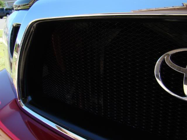

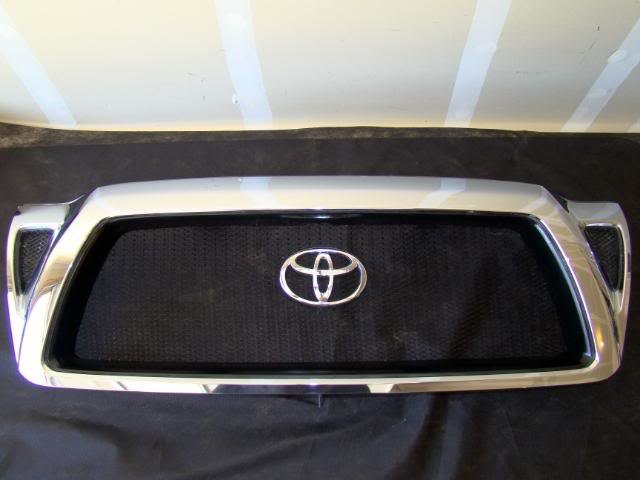

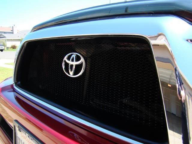

    For those who wanted some pics here are some of one I recently sold on ebay. Not sure if he's a memeber of TW or not but if he is I'll get him to post up some pics and feedback when it gets installed.
    I also took some pics of the one currently on my truck but then realized how dirty it is when I reviewed the pictures. :puke:
    I'll have to wash my truck then post up pics of mine.

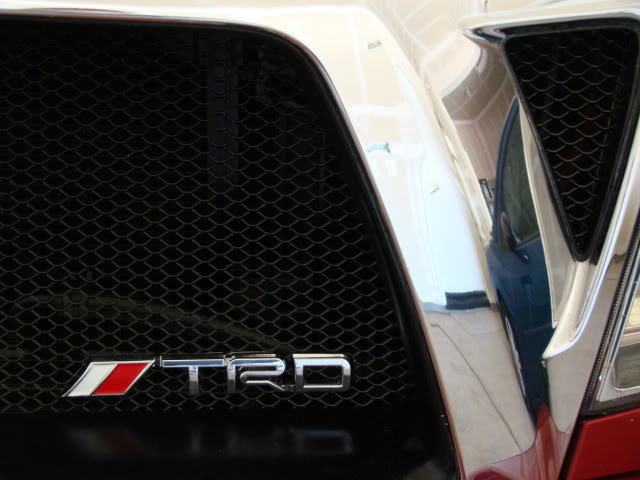

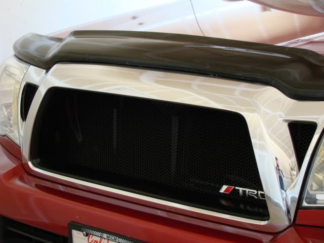

    A couple pics of some of my work:
    My personal grille, done with customcargrills.com mesh
    The one I just sold on ebay, formerly chromed and now primed and ready for paint, done with Lowes mesh.

    I hope you made it clear to the buyer that was a chrome grill? You don't want the buyer to be pissed when the paint starts peeling off.
    I remember seeing that auction. But I don't recall it saying it was a primed chrome grill?

    I like the grille on your truck with the trd emblem.how much would this cost with the emblem?

    I stated in the auction, as well as the for sale thread I had, that it was formerly chorme and now sanded and primed with adhesion promoter. Everything is on the up and up and the buyer is aware.
    I know you weren't implying this but I don't half ass anything and not trying to screw anyone over.
    I'm looking to keep this as simple as possible as well as inexpensive as possible for everyone involved. The mesh on my grille cost $70 for the sheet I used. If I offered this to others then that would automatically jack the price up by that much.
    I use Lowes mesh, blacked out with Krylon Fusion and then with a clear coat. It's inexpensive and works just fine. If anyone wanted to swap that mesh out at some point it would be easy to get ahold of whatever style wanted and then simple attach it with zip ties through the mounts I attach to the inside of the grille.
    As for the emblems, I don't have any top secret method of attaching the emblem. Just a small zip tie or two ran over the emblem, in discreet locations to keep it clean looking, and then back through the mesh. Anyone could easily get whatever emblem they choose off ebay or any other source and attach it themselves in literally 2 minutes.
