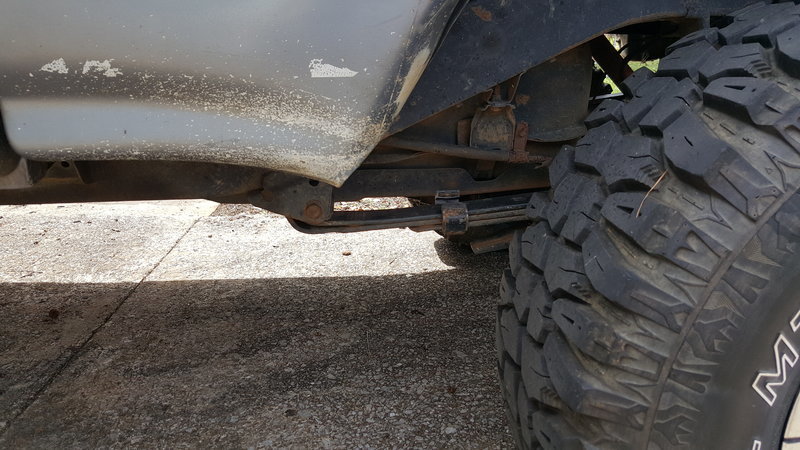

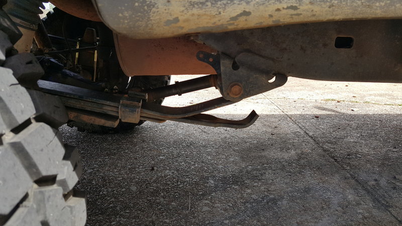

    Leaf came off a low miles tacoma And it's tweaked a little what's ur thoughts planned on replacing with new this summer

    This is driver. Compared to pass.

    tweaked a little?
    It's done being a leaf spring.
    replace it yesterday

    I for sure would not want to drive that very far It has to handle rather poor.
    It is not tweaked it is broken!!!
    Time for two new rear springs they are not that expensive.

    Ok so fixing to make the order do yall Recommend changing shackles too

    I agree with others, replace for sure. also the drivers side looks flat and worn out as well.

    I would wager that the shackle bolts are rusted into the spring bushings. You will have to cut the shackles if they are rusted too bad. Better to go ahead and order them with the springs. Same goes for the front spring hanger bolts and possibility the u bolts, too.

    I just cut the U bolts off Shackle Kits from Toyota New Spring Hanger Bolts as Well I have never been able to ever get old bolts out of the Metal sleeve in the Bushing

    I used some knocker loose sprayed on last night everything came apart smoothly
