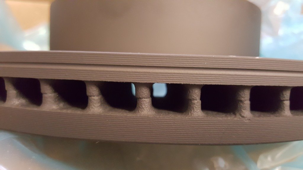

    I ordered some OEM Tundra rotors from a Toyota dealer through Ebay. I went with OEM, which cost more than the super cheap rotors because the casting is MUCH cleaner and in my experience the rotors don't warp as easy. Anyways I got around to opening the packages and one of the rotors has a single imperfection shown in the pictures below. Would you think that this will become a weak point or hinder the overall performance/longevity of the rotor? I'm on the fence about contacting the seller to get a replacement. Just looking for insight, thanks.

    I'm gonna say send it back.

    Are you certain those are genuine OEM? I wouldn't trust EBAY

    I would definetely return it!Never seen a rotor what so ever in my life look like that!I'd make sure as well that is OEM Toyota as well.

    They came with an invoice from a Toyota dealer and in Toyota boxes. You can see how clean the casting is (minus the imperfection I'm posting about), which no other cheap rotor has. Also the seller has a great seller rating.

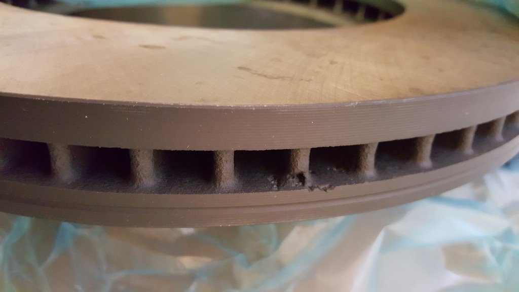

    Yeah I'd send it back. Why not get one that isn't flawed if you can? Sometimes I wonder if this stuff ends up on eBay on that chance that someone will just grab it with the intention of putting it on someone else's vehicle = everyone is happy! Until it causes a problem in two years.

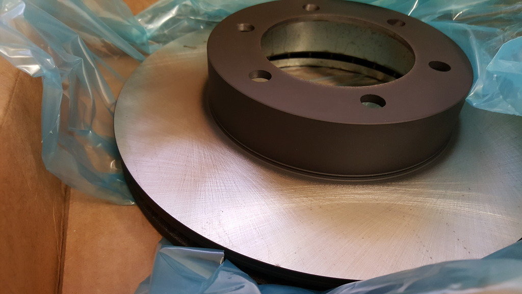

    ^Now that I'm looking at the other rotor it looks like where the metal was cast together they didn't line it up evenly...I'm going to see about returning both of them.

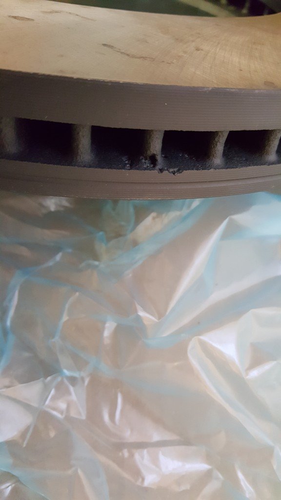

    The second one is far worse then the first one.
    Maybe why the were on ebay were they sold as seconds ??
    Bad day at Quality control they both should have failed

    Also keep in mind that the defect is one of the cooling fins if they try to say its no issue

    personally they look pretty bad and I have never seen a casting looking like its two separate castings joined together?

    The casting imperfection is most certainly not normal. We did check the rest of the stock on the shelf and it appears that the line down the center of the radial cooling fins is normal on this particular rotor. Although, it is only evident part way around the rotor, never visible from 360 degrees."
    So they're saying that pitted rotor was definitely not good, but I think they're saying that all of their stock has that line in the center of the cooling fins that looks like the rotor was cast from two separate pieces.
    **Upon looking at the rotor with pitting on it, it also has that weird off centered looking casting on about 1/3 of the cooling fins as well.
