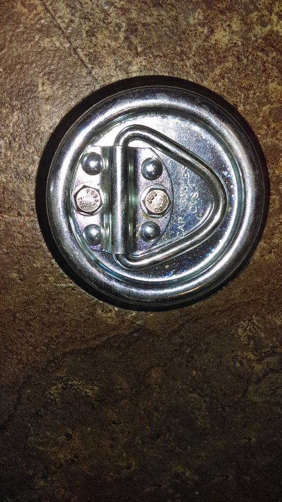

    These factory D rings in my toy hauler read 1,500 lb. capacity cvs stamped on them
    Not sure if thats breaking strength or working load limit?
    Anyway they go through the wood floor of my toy hauler and also threaded through 1/8" thick steel frame. I added flat washers,lock washer and nuts to them underneath so they wont pull through.

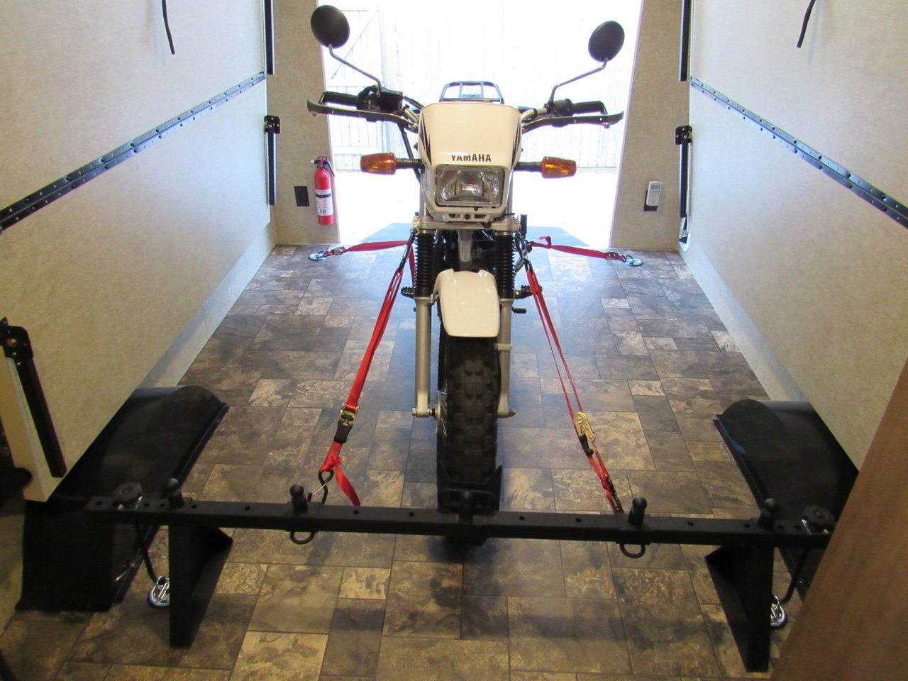

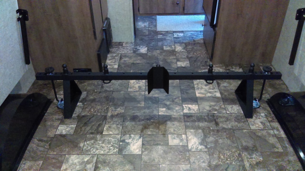

    I will be hauling a TW200 that weighs 300 lbs on a beast rack set up

    I think you are gtg...1,500 is for one...If you were 350 Id be a little leery. If you are in an accident it could change things but for normal safe driving I think you are fine.

    Yeah, those'll work fine. We had that kind in our toy hauler and never had a problem

    I had a Forest River Sand Piper Sport toy hauler with that kind of D ring and I tied my sand rail (1600lbs +) to them without any problem.

    Here's the Tw200 in there using the Beast rack I ordered from California
