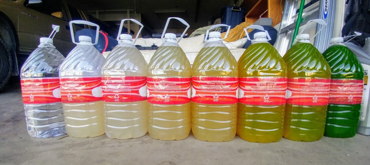

  10. May 12, 2019 at 6:38 PM
    #50
    greengaint97
    greengaint97 [OP] Well-Known Member
    Jan 22, 2019
    #280241
    285
    Al
    Colorado's Western Slope
    SOLD: 01' TRD xtra cab 3.4L five speeder
    Well, the coolant flush has commenced. I've gone through 8 gallons of distilled water, and still have one flush to go. Then tomorrow after an hour or so of driving around with just distilled in the old OEM radiator, I'll drain once more and the new radiator (currently sitting in the garage) will go in.
    This works out well because I am waiting for new silicone radiator hoses from LCE Engineering. Opted for those after finding out the HPS ones off of Amazon were recalled (glad I didn't end up with those!).
    Thought it would be a neat photo to line up the jugs of distilled that have come out of the truck as a result of the flushing I've been doing. In the photo, the far left one is distilled water that hasn't been tampered with - I put it in the photo for reference only. (see below)
    Hoping the new radiator and Toyota Red will bring my operating temp down. Would be so happy to get out of the high 180s! Fingers crossed:fingerscrossed::thumbsup:
