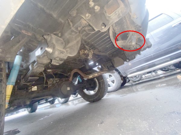

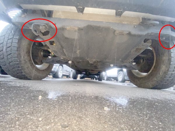

    $23k for a 13 year-old truck with 3 accidents on record? What's your plan for the vehicle? Daily beater? Trail beater? If so, wait a month. If the truck is still on the dealer's lot then, offer $13k.
    What years did the 3 accidents occur? I see the truck has had a frame replacement. The LCA and cam bolts (come with the frame) look new, while the brackets attached to the cab floor are rusty. I see a bent skid plate, missing engine skid, incorrect recovery hook for Off Road package, bent crossmember extension on the driver's side, and possibly bent trailer plug connector. Washer pump not attached suggest the accident crushed the fender and radiator support up to that point. Do you mean wipers are inoperative or mechanically not attached? The latter suggests a cracked windshield replacement.
    Thermostat is easy to DIY. Given the truck's age you'll want to replace the coolant, radiator hoses, fan belt, idler pulleys... anyway. 13 year-old factory spare would be junk, probably why it wasn't reattached when the frame was replaced.
