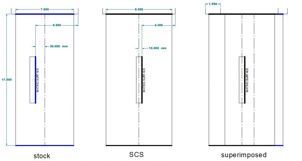

    i'm new at this stuff so i'm drawing simple pictures in CAD to understand the concepts of backspace, offset, etc.
    i understand the wheel width is the inner size of the rim, and the offset is measured from the outside of the rim flange. i also understand everything can be off by a few millimeters.
    i am looking at the Stealth 6 rims. they are going to stick out almost a whole 2" - not to mention a little more bubbling due to the 265/70/17.
    i know i may need to remove or trim my front mudflaps.
    please help me understand, is the above correct and will they really fit?

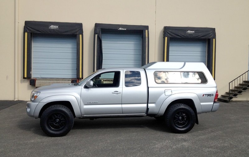

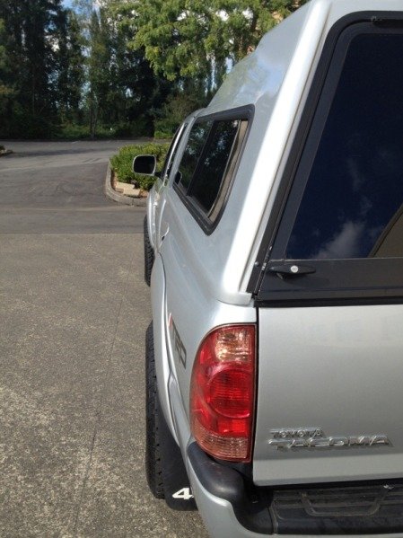

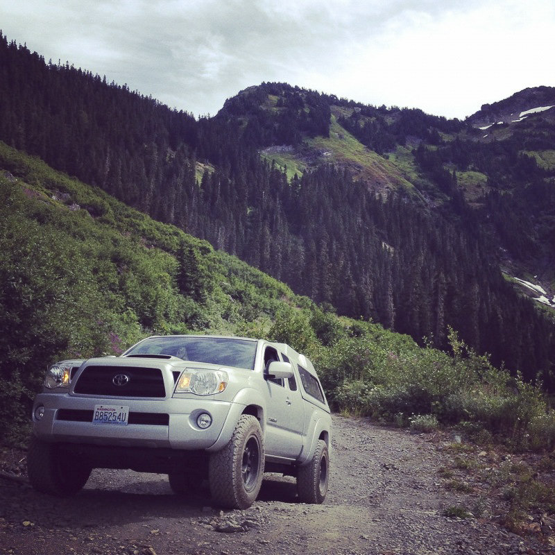

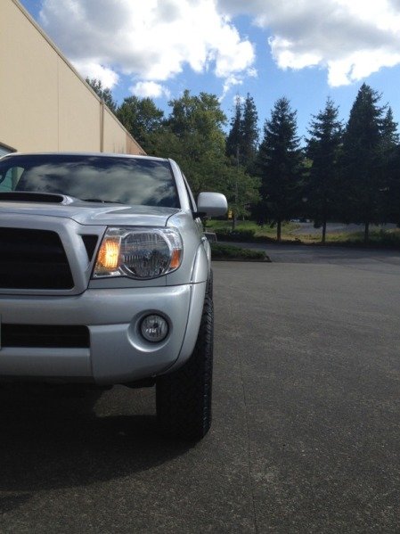

    The Stealth 6 with 265/70/17 will fit with no lift as long as you remove your mudflaps and do a little bit of trimming. For daily driving, you might get an occasional rub on the cab mount every now and then. If you plan to off-road, definitely do the CMC mod. Jerry from BAMF sells precut plates that will the job a breeze.
    Stock with 265/70/17

    The wheel may be wider than stock, but the tire isn't. With the Stealth 6, your tire will stick out 40 mm or 1.6" more than stock.
