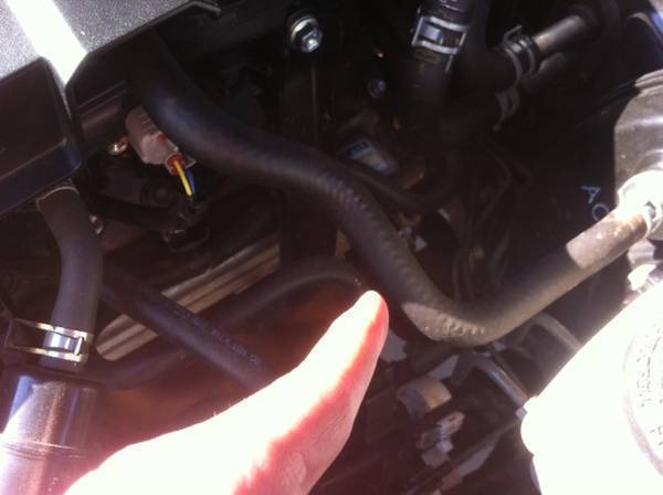

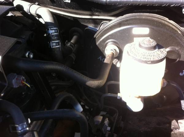

    OP
    could you upload some pictures of the vaccum intake line on the brake booster, or whatever hose you pull off to pour the seafoam into?
    I am ready to do it, I just need to know the exact hose. I will make a video and take pictures, and blah blah blah...

    One second I will
  14. Mar 10, 2011 at 4:51 PM

    awesome...
    so you unplug it from the brake booster and pour half the can in...
    should I keep someone in the cab on the gas, to keep the engine revving higher?

    A few tips to make it easier. Use a 1/8" clear plastic hose from an auto parts store. Unplug vac line from BB like toyo freak and then insert hose in to vacuum line. Once you have suction on the plastic hose, insert it in to the can. You can crink the hose as needed to ensure volume. It also makes for a cleaner operation. If you throw a CEL, its probably just a misfire from the ignition reaction to the seafoam. Go on down to the closest Advance Auto Parts or Auto Zone and use their OBD II reader to clear the code. Whammy you should have a cleaner engine.

    don't 'pour' in in the hose line. If you start the truck up, un-plug that hose and then dip the hose into the can you can control the idle of the truck by how hard you dunk the line into the can. What I did on my previous trucks was let it suck up about a 1/3 of the can, then totally dunk it in there so the truck will die and let it sit for a while. Then drive the truck up and down the road and let it burn it off. My experiances were tons of white 'smoke' leaving the truck.
    Everyone concur? I've used this in ALL my vehicles, atleast in the fuel system from time to time. Mechanics I've talked to also said the AT seafoam really breaks down ATF so only put that stuff in the system if you are ready to have a full flush, but I've only had sticks until the Taco so I never ran the AT treatment.

    You want it to "sip" the Seafoam, not chug.
