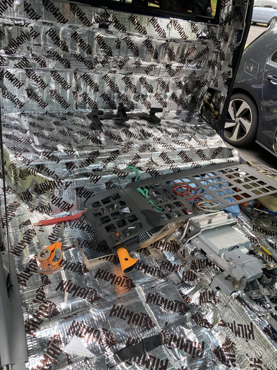

    As long as you’re interior paint is good shape no need for rust worries. I also did my truck and made a big difference. Especially when you close the doors they actually sound solid and not hollow and tinny 1AB0AD22-5354-4AE8-8292-6087400C5669.jpg
