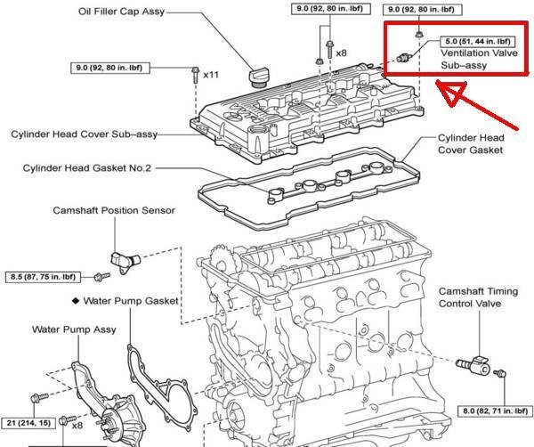

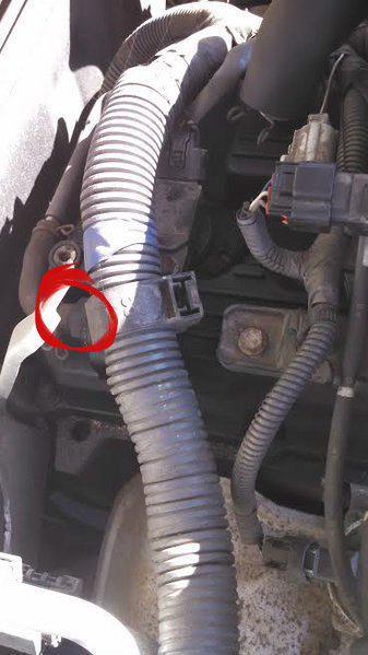

    I'm starting a new post from the original 'Blue Puff of Smoke on Start Up'.
    YOU GUYS WERE 110% correct (not like I doubted you). The technician working on my 2008 2.7 Tacoma told me yesterday my truck did not have an external PCV valve and could not be changed without replacing the entire valve cover. Thanks to you guys and your information and images I finally took a picture of mine. It was exactly where you guys said it was. I called and emailed the service manager, explained the situation to him and explained I do not trust anyone in that dealership to ever touch my vehicle again. I don't know if my plugs were ever pulled, etc. to check for the original possible oil leak. Well the service manager seems livid with the technician and pissed off to the highest level of pisstivy (or he's a damn good actor). He said of course there's a PCV valve and your picture even shows it and I have one in my hand. He offered to change it etc. personally free of charge and would deal with the technician immediately. I told him I appreciate the offer, but I will not was my time or gas driving another 30 miles for a $7 part.....I suggested he just deal with his incompetent Toyota Expert technician, that's should be your top priority as he shouldn't even be allowed to wash cars without supervision.
