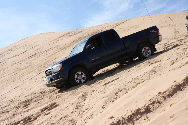

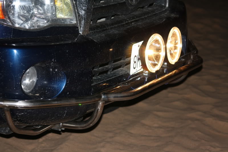

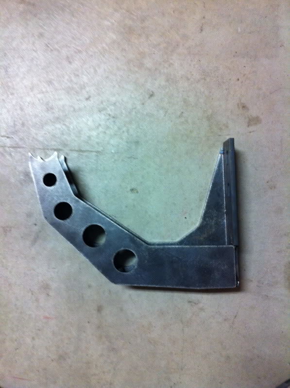

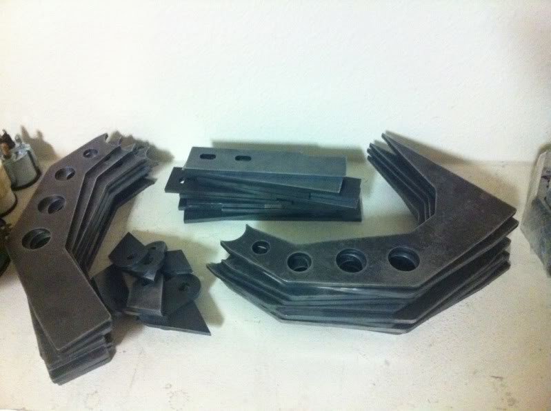

    Picked up my laser cutting today on my way home from a trip to the sand dunes!!!
    Light bar worked great, I even hit a few things with it and had zero issues.
    Here are the laser parts:

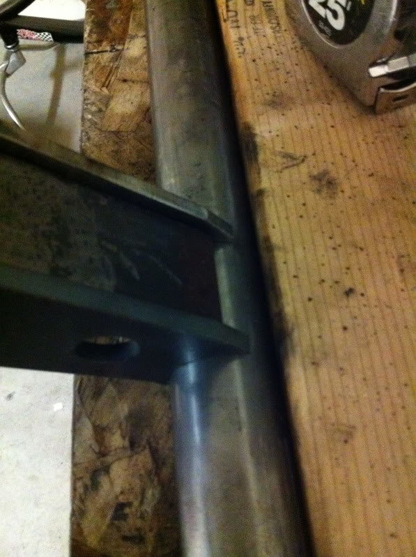

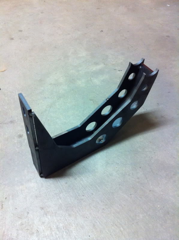

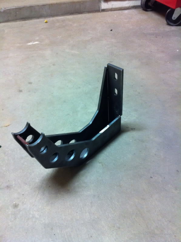

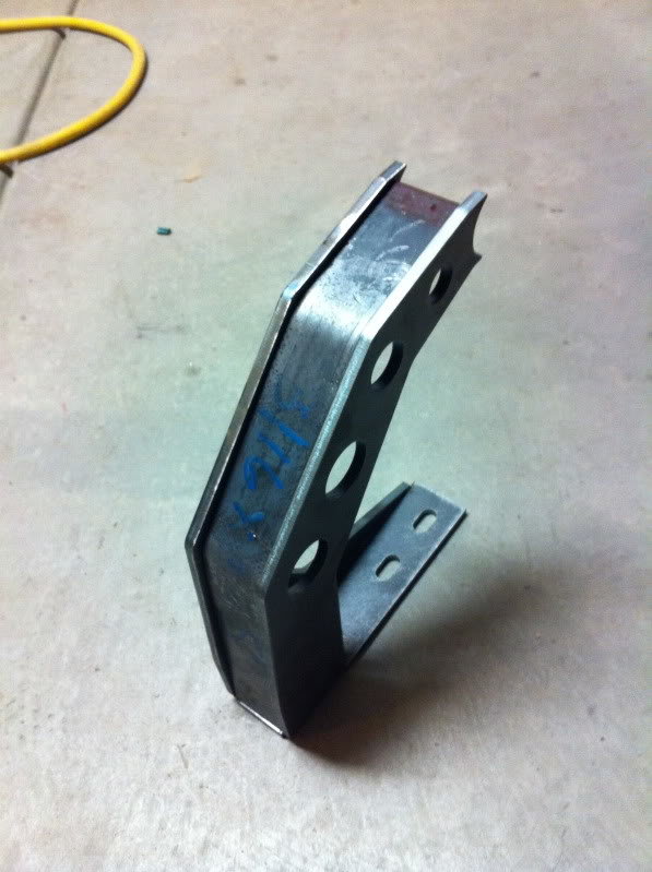

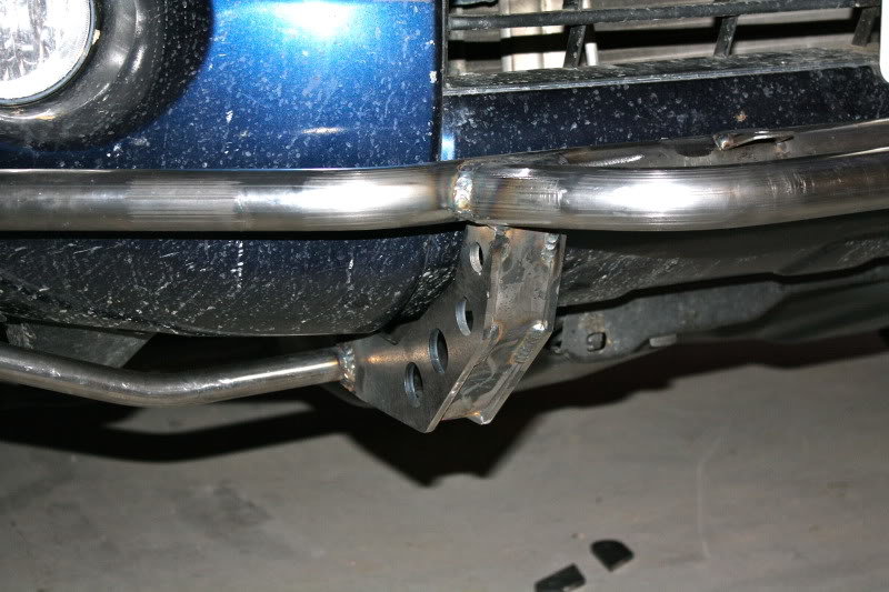

    Tach welded the new risers together just now to get a glimpse at the final product... these things are going to be super strong and look awesome! snapped a few iPhone shots, I hope you guys enjoy... Should a have a final product together by Friday so you guys can see exactly what your getting.

    how would you say these would hold up in an accident, say up to 10-15 mph? I dont know much about materials, but if you were to make it out of tubing that you'd use for sliders, wouldn't that make it pretty solid?
  10. Dec 21, 2011 at 7:08 PM
    #30
    PELLEY
    PELLEY [OP] Well-Known Member
    Aug 21, 2011
    #62089
    386
    Hard to say about accidents, there are a lot of variables, what you are hitting, how fast they are going, at what angle, etc... but I know it will hold up great when in the dirt, if you hit a rock or branch in the trail, or someone slides against your bumper in the parking lot, no issue.
    For material and the engineering behind plate and tubing... The risers which are made from 1/4" plate are way stronger than the tubing equivalent. The material is much thicker, and the way they are made, there are no bends in the material, unlike tubing which loses some of it's strength when you bend it. The rest of the bumper that is made of tubing is 0.120 wall, which is very close to 1/8". It is the same thickness you would use to make sliders, so you can expect that it will stand up to the same amount of abuse.
    Really the weak part of these bolt on bumpers/light bars, not only mine, but any that bolts onto the stock mounts is the tabs on the frame where they bolt to. It is only 1/8" plate, and us not supported well. Then they only use three 7/16 bolts, so there is not a ton of shear strength there. Overall the bumper is much stronger than the mounts, so you will see the factory mounts fail before the bumper does. But for what most of us do, which is part time dirt use, and for added protection on the road from the minor impacts, these things will be great and handle that stuff with only a scratch in the paint!!!

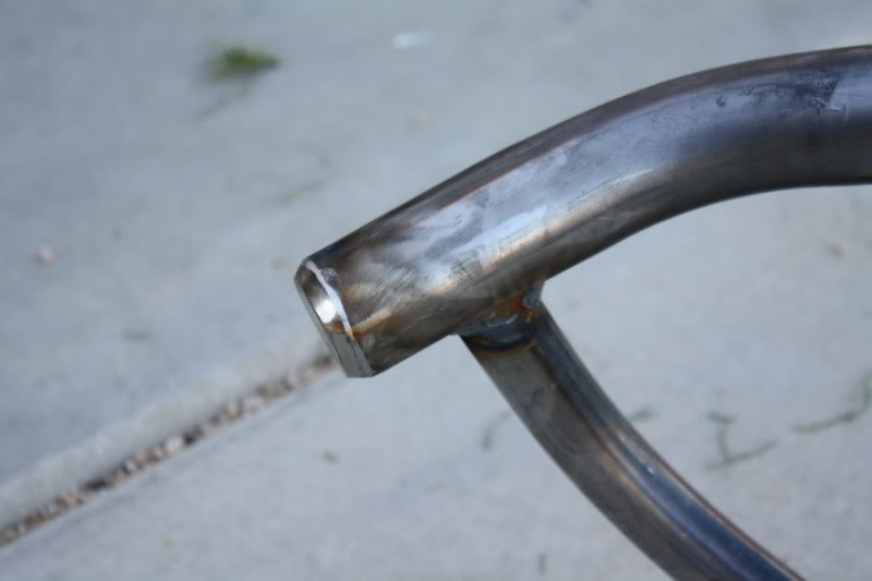

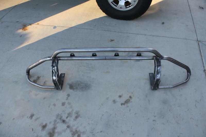

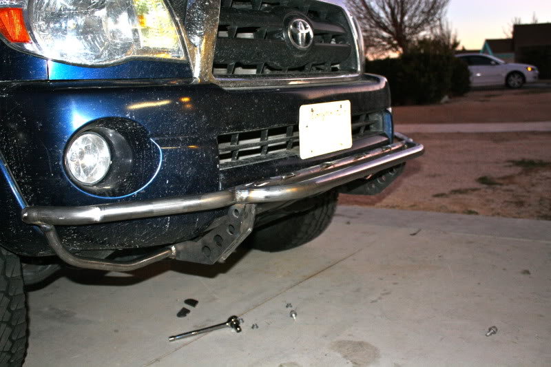

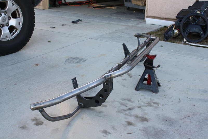

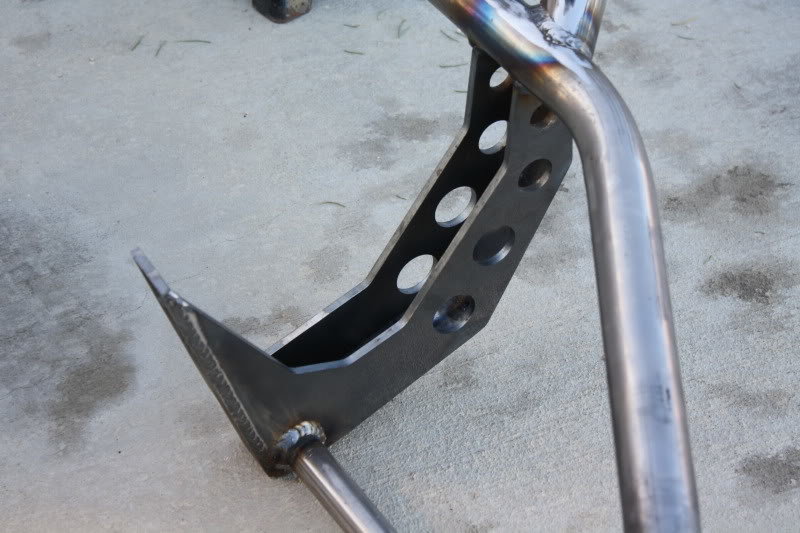

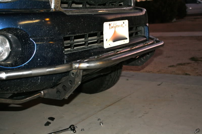

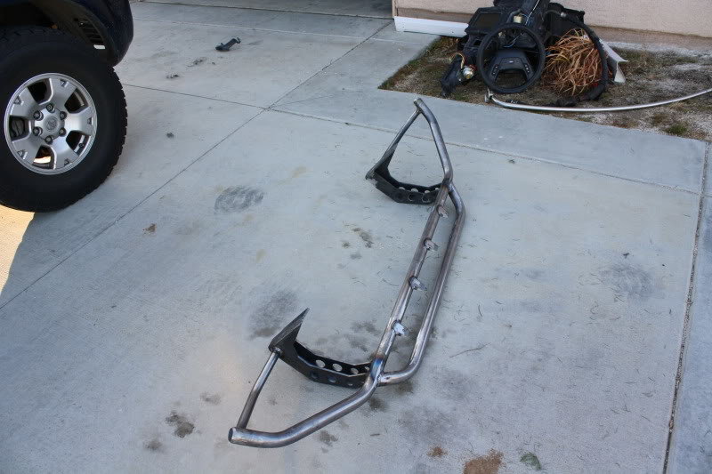

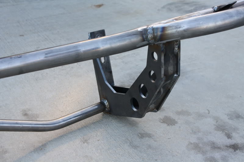

    Pictures of the raw finished product!!! Will have powder coated ones early next week. Will post some day time shots on the truck tomorrow as well. Enjoy!

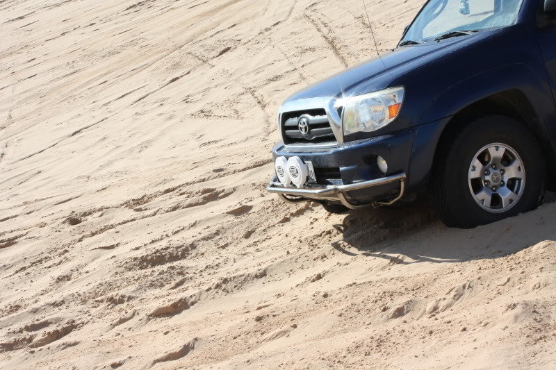

    Also got a few shots from my dune trip with the prototype, thing worked great. I hit it on some stuff with zero issue, and the lights were in a great position on the truck.

    Hey PELLEY, I really love the new risers. You have me thinking here man. I might have to go with what you are building. It looks sick. Great job Brother.

    Looks damn good :thumbsup: I like that you incorporated plate into them and not just tubing.
  20. Dec 29, 2011 at 7:23 AM
    #40
    Steve J
    Steve J Steve J
    Sep 28, 2011
    #64261
    516
    Steve
    Canyon Country Ca
    12 Access Cab 4x2
    Avid front light bar, Avid bolt on sliders, Avid rear bumper protector, T-Rex grill & bumper insert. Still lots to do though.
    The plate definitely sets it off & sets it apart from all the others.
