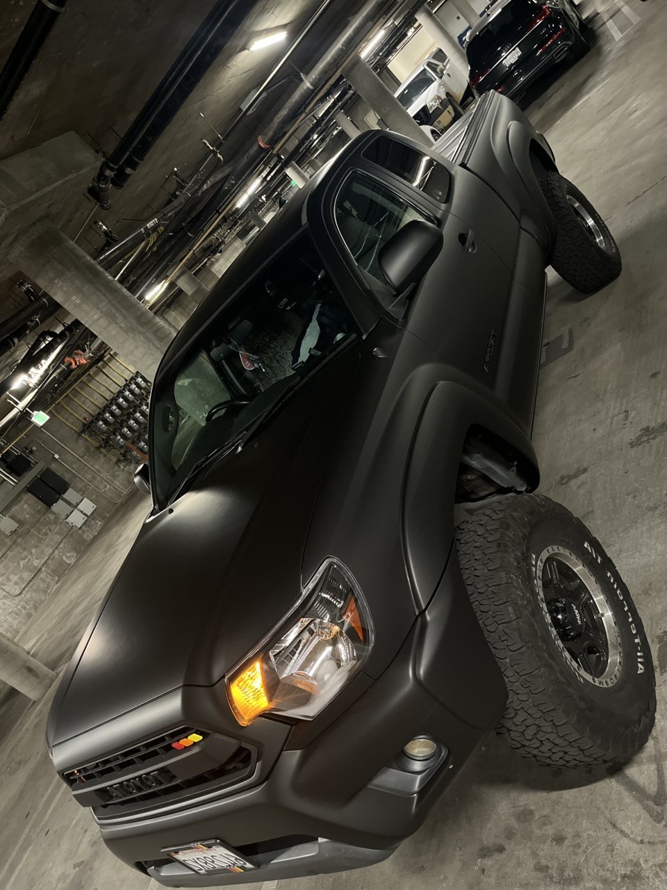

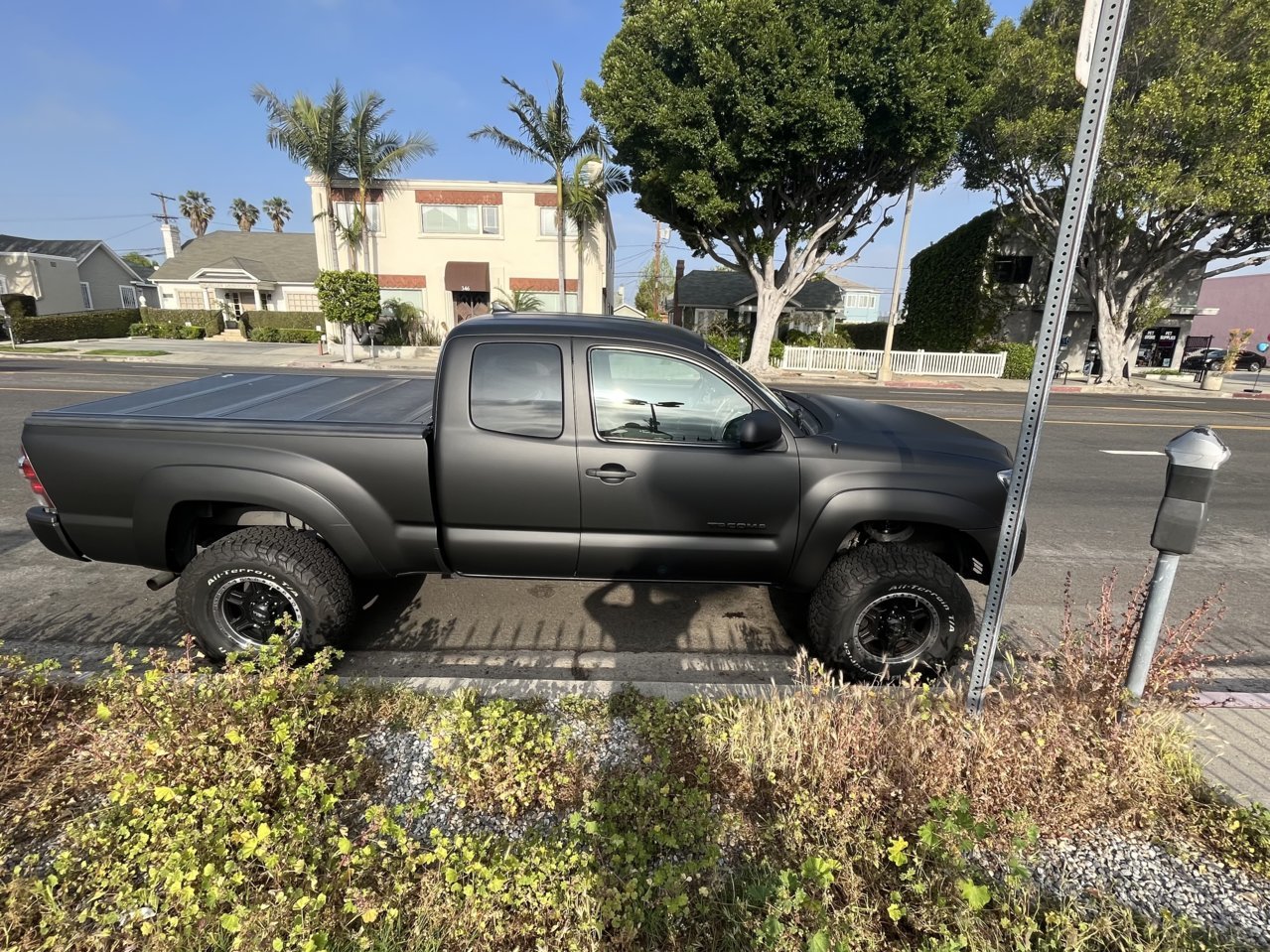

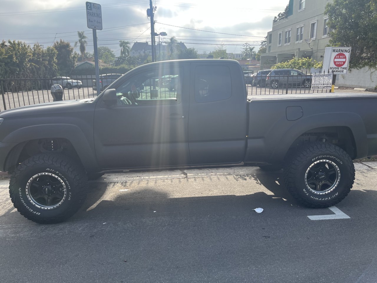

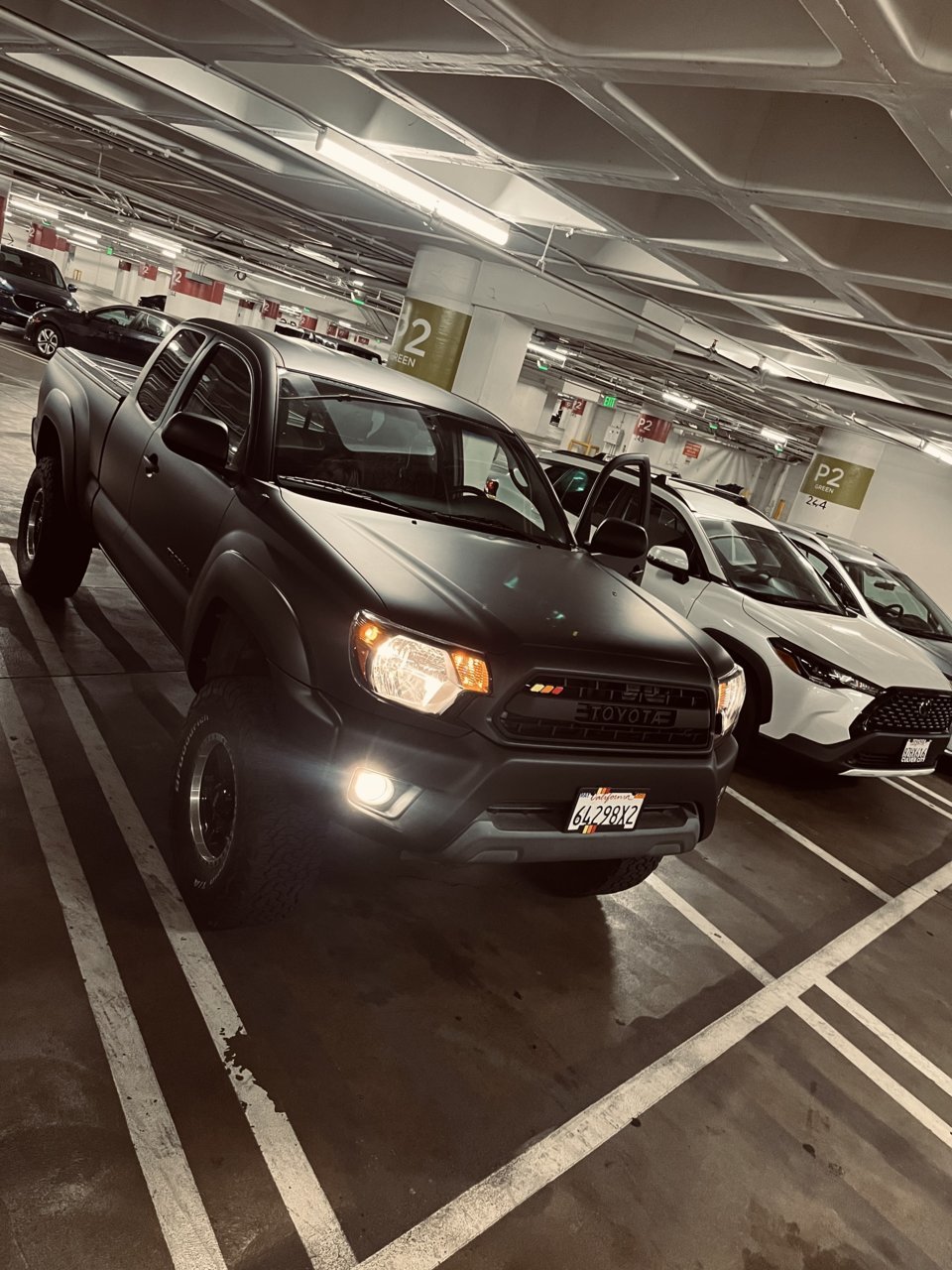

    C749A404-A264-493D-A24E-4D9F124CCE7B.jpg BEA01F90-AF4F-4E18-8811-15F46ECC2053.jpg

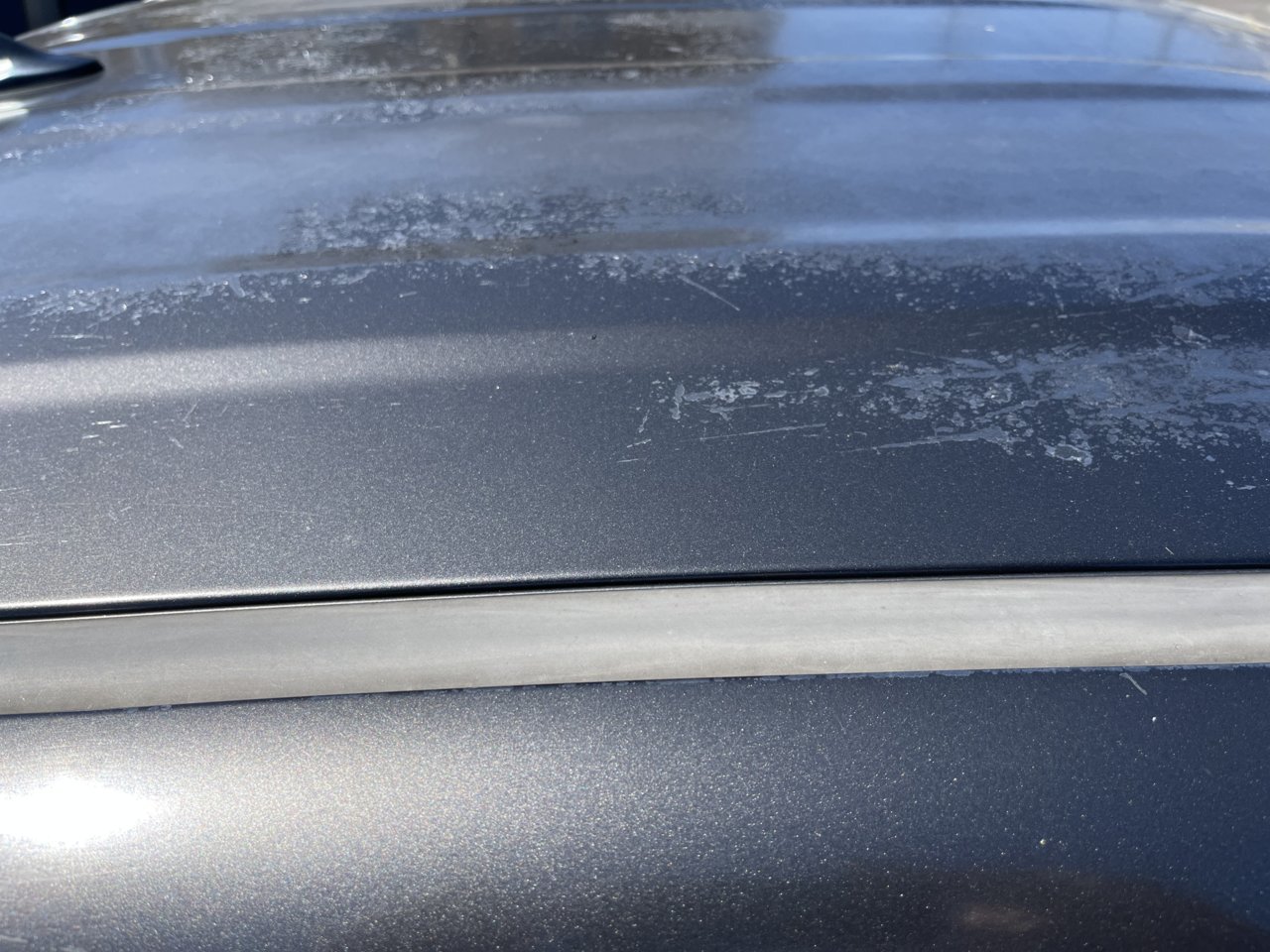

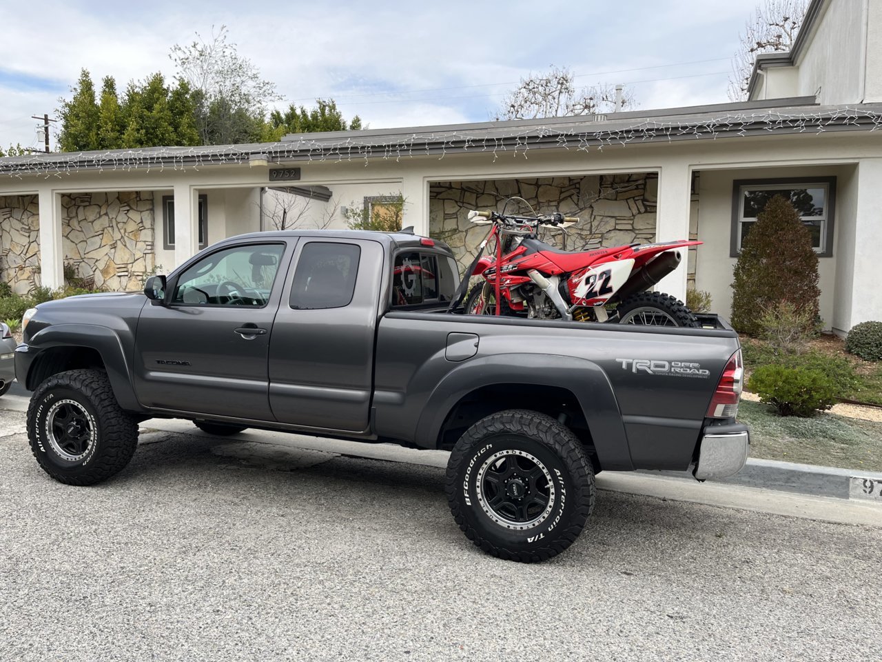

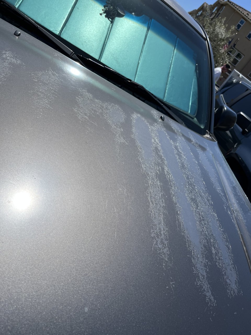

    Here’s what she looked like before
    FC01D452-BA8E-48C1-9964-F4762A88EB23.jpg 1019AD20-1344-48D8-B2BF-C196C7529916.jpg 4E1D7969-48B9-4615-A47C-4F4D66F0B3C3.jpg
    Couldn’t stand the sun burn or the fogged headlights or the beat up bumper so I shelled out some cash
    Hope you guys enjoy

    That looks bad ass!!!
    Matte or satin?

    Hells yeah! I approve! Love that satin.

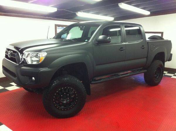

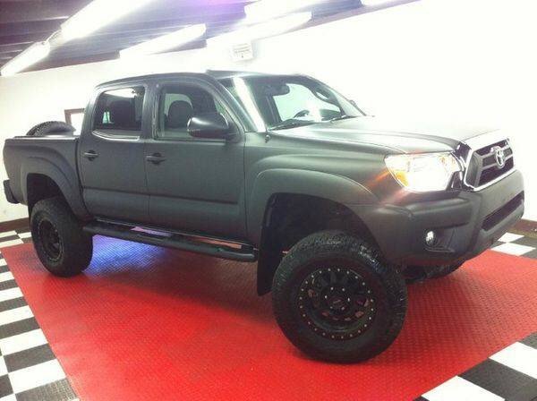

    I see one of these in your future :)

    That looks really nice! Do you know if the installers did any special prep where the vinyl was going over the iffy clear coat spots? Looking to do something on the roof of my truck possibly where the clear coat has failed.

    I've wrapped cars with failing clearcoat and it has to be sanded completely off or the vinyl won't stick or the clearcoat comes off on the vinyl when trying to reposition and the whole piece is ruined. Ive done it with a razor, sander etc. It's a PITA which is why alot of wrap businesses don't like to do those. It can be done without sanding off the clearcoat completely by blending it in but some imperfections will show through especially on gloss vinyl. Vinyl with patterns on it like carbon fiber not as much.
