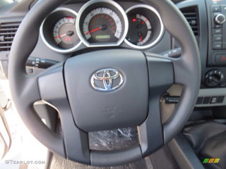

    I hate my leather wrapped steering wheel and prefer a polyurethane type. Question: for those of you who have older steering wheels with wear (peeling, smooth, etc) has anyone just removed the cover?
    What does the steering wheel look like underneath? Is it like an unwrapped textured wheel?
    I would swap my covered s-w with on of thesee4b7fe5ed8c25017d672dd61068bebd6_f8b520ab3457237b2b81064a797571a6f1e88bd7.jpg

    im willing to pay 220$ for a non leather steering wheel. How hard could it be to swap them out?

    Well it's 223 plus whatever shipping. There may be a member here that can sell it less to us?
    http://www.toyotaonlineparts.com/to...steering-wheel-scat/?part_name=steering-wheel
    You just need to know how do properly stop the electrical circuit in the vehicle and then follow the instructions to remove the air bag.
    Your controls and such will swap over... I am pretty sure of that.
    I added factory cruise to my 2013 RC Auto and it was easy.
    Last thing is the wheel will have threaded holes for a puller if needed, I haven't needed one in years but have only removed wheels from Honda, Acura and Toyota vehicles.
    My trick was loosen the nit holding it on but leave it on there, then I would tap on the shaft with a small sledge, like a 3lb I think. It usually does the trick,
    Oh and don't forget to use some touch-up paint or a silver sharpie and mark the orientation of the splines/wheel etc...
    I had to R&R a wheel because I didn't do that.

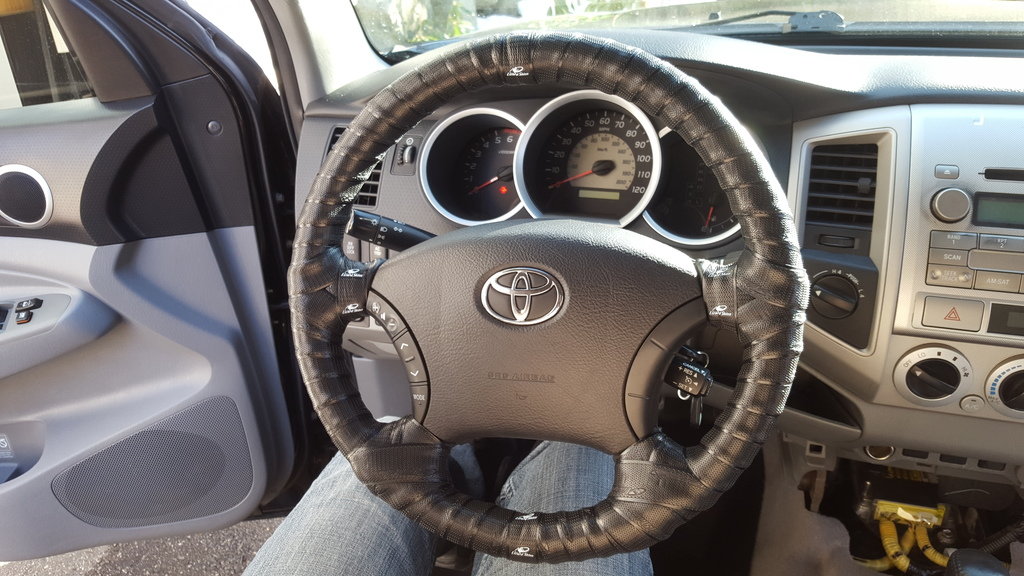

    If youre looking for an economical and functional wrap, I re-wrapped mine with bicycle handlebar wrap. Cost $80 and took about an hour. Its very comfortable (its padded) on the hands and has excellent grip. Aesthetics are questionable. 20160218_145640_zpsbdxmug1z_07b7d7eca472eafa5ca54b90e1215c39c6e6174b.jpg

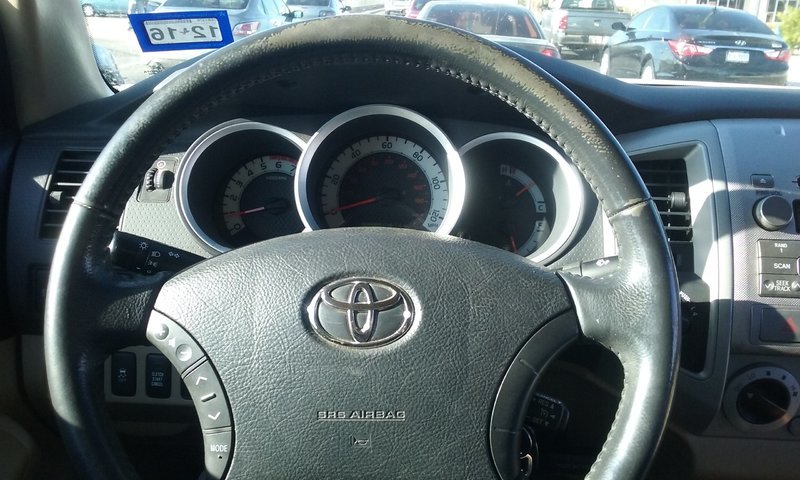

    I feel you man, my steering wheel looks like from the 90's and it's only 5 years old

    I will give this a try: check it out http://forum.e46fanatics.com/showthread.php?t=681976
