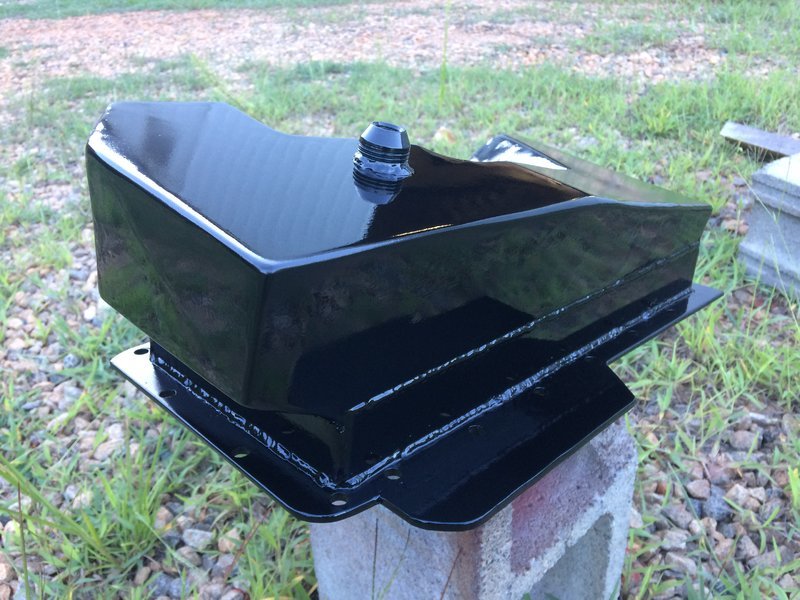

    Nickel and PintSize like this.

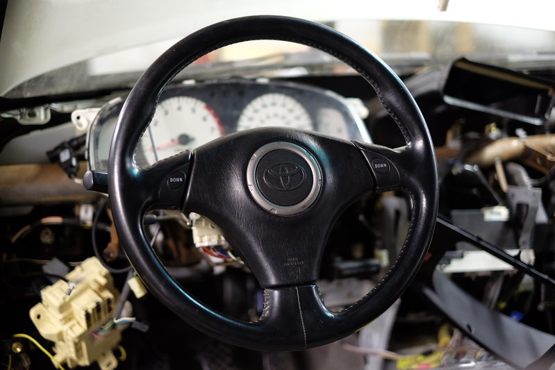

    IMG_5114.jpg Lexus IS300 steering wheel with RAV4 airbag. (I'm still wiring up the cluster, so forgive the torn apart dash.)
    Nickel, wat0023 and Silverspool like this.

    Post #61 gives a quick overview of the set up.

    Is the IS300 steering wheel and RAV4 airbag a straight clip-in and bolt-on swap? I'd like to upgrade from the 1st Gen's soft thin plastic steering wheel. OEM is nice.
