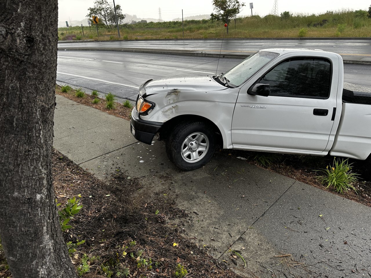

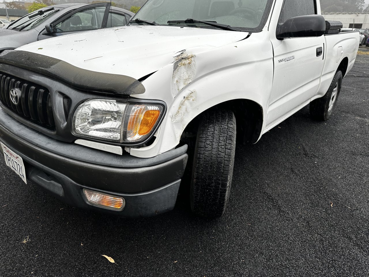

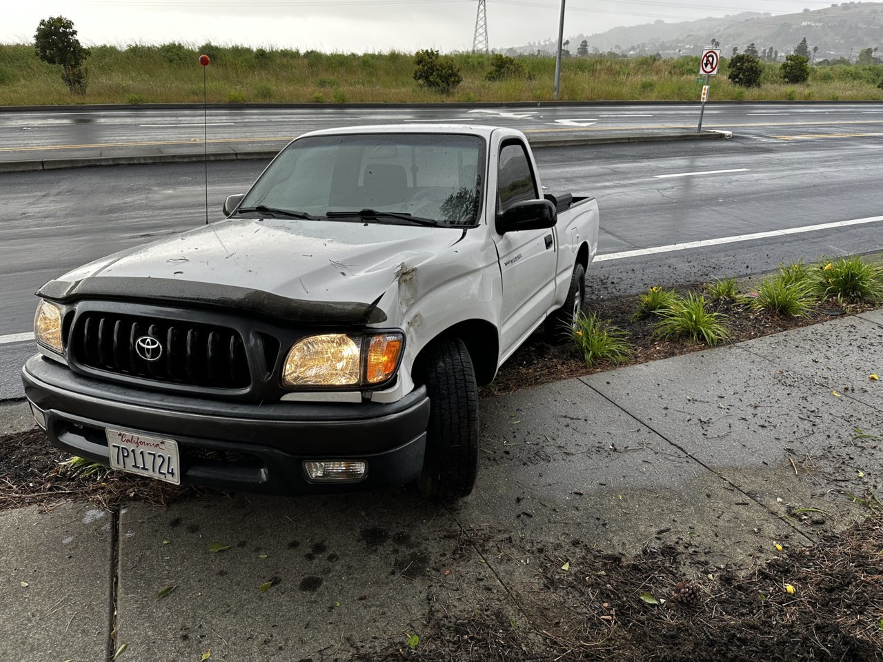

    Hey 1st gen peeps,
    I was on my way to work this morning lost control in some rain, and crashed into a tree. Thankfully I’m ok and no one else was involved.
    i don’t have collision on this truck, but from what I can see it doesn’t look too bad? Can y’all let me know what looks like needs to be replaced and ballpark prices or where I can order parts?
    I drove the rest of the way to work and it ran as usual. Some tire rub from the plastic bits in the wheel well. But I’ll know more when I drive it home later.
    thanks in advance!!

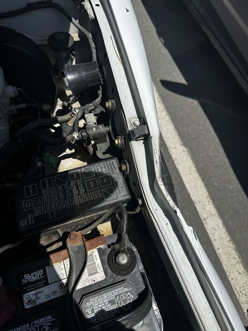

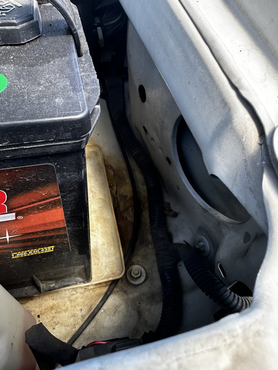

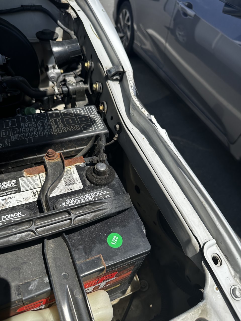

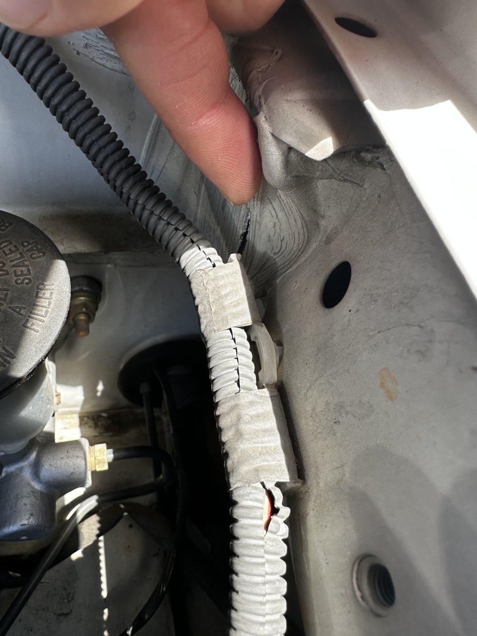

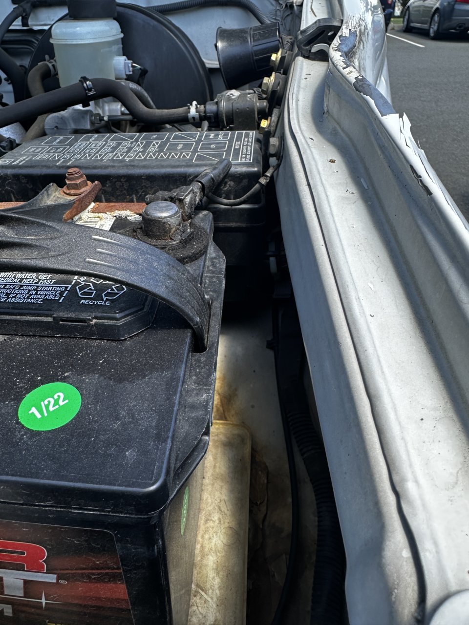

    UPDATE: Added inside hood and underneath shots:

    Looks like you just need a fender and hood, assuming it still drives straight and nothing got bent in the suspension or steering
    I would just keep an eye out for a used fender and hood, could probably get them both for under $500 used. Easy DIY job, just nuts and bolts. They sell aftermarket ones too for pretty cheap but fitment can be a little less than perfect, and you'd have to paint them.

    I don't know if you plan on doing this yourself, but my guess would be that it would be $2,000-$3,000 through a body shop. This is exactly why I have collision and comprehensive on my 2010; I was involved in a freak accident at a scrapyard 15 months ago that wasn't my fault, and the scrapyard's insurance paid for it. My passenger door had to be replaced, and there was also some fixable damage to the rear fender and a bit of paintwork. Total was about three grand. Insurance companies very rarely pay for brand new OEM parts, especially on older vehicles, and buy parts from totaled trucks. This is where my door came from. To be sure that you are getting genuine Toyota parts, your best bet would be to buy parts online from a totaled truck and have them shipped to you, then have a body shop do the installation and paint work.

    I updated my original post with more pics of the inside. Is she bent?? What are your thoughts on repairability and safety if the frame is fixed if it’s bent?

    The frame is probably the least of your concerns. Probably the fender bits, including the inner parts, as well as the hood could be replaced with junkyard parts.
    I would be very careful with your left sided suspension components, make sure nothing is broken.

    Does it drive straight like before? If you bent the frame you would know it when you drove it. It's more likely something in the suspension (control arm, spindle, tie rod, etc.) would get bent and those are easily replaceable.

    The apron might need to be repaired...

    I took it to shop #1 and they quoted me 5k. Said the hood, fender, alignment, radiator support, and apron needed to be repaired.
    I’m hoping the second shop comes in much lower and that I’m able to have either of them fix the apron and radiator support. Then I’ll handle the rest of the cosmetic stuff… prices in Marin county are wild for labor so that’s not helping me there.
