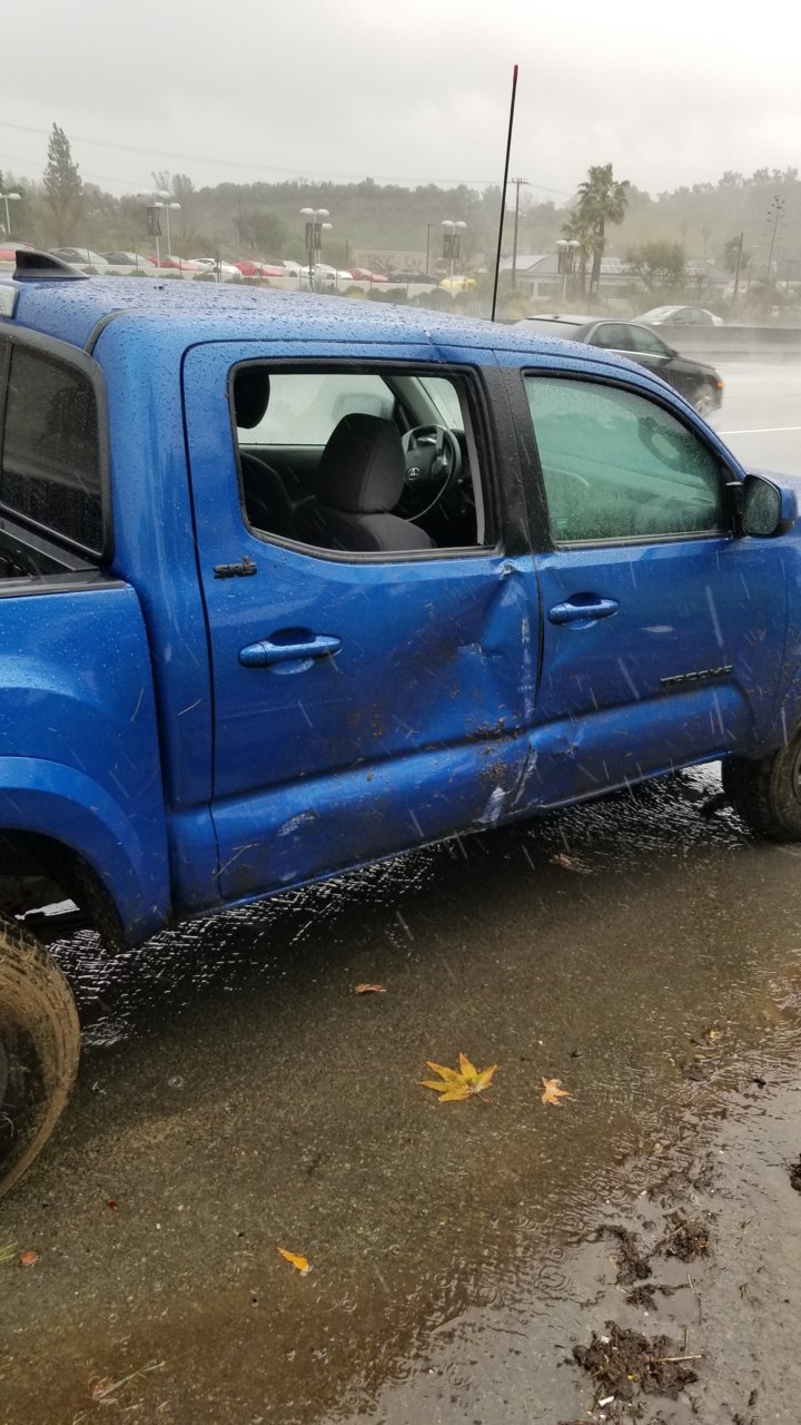

    curtains didnt deploy good. The accudent didnt trigger the needed protection of your airbags.
    If there is pillar damage .....not good...even uf its puny.
    Typically air bags and pillar damage or either make it totaled. Insurance companies are quite happy totaling your vehicle.

    Ouch. Same color truck as mine. Ins. will not total it unless you have over 2/3 the value of vehicle in damage. Was there anyone sitting in passenger seat? Air bag is controlled by seat switch. As for hydroplaning they say you only have one inch of tire on the ground when hydro no matter how wide tire is. Good thing is your truck protected you. Good luck with ins.

    Yea, no chance on a total there, looks very much fixable to me. Glad your ok though. I drive in the same weather. It's scary out there, not just to us but those who decide to go full retard even for a drop of rain.

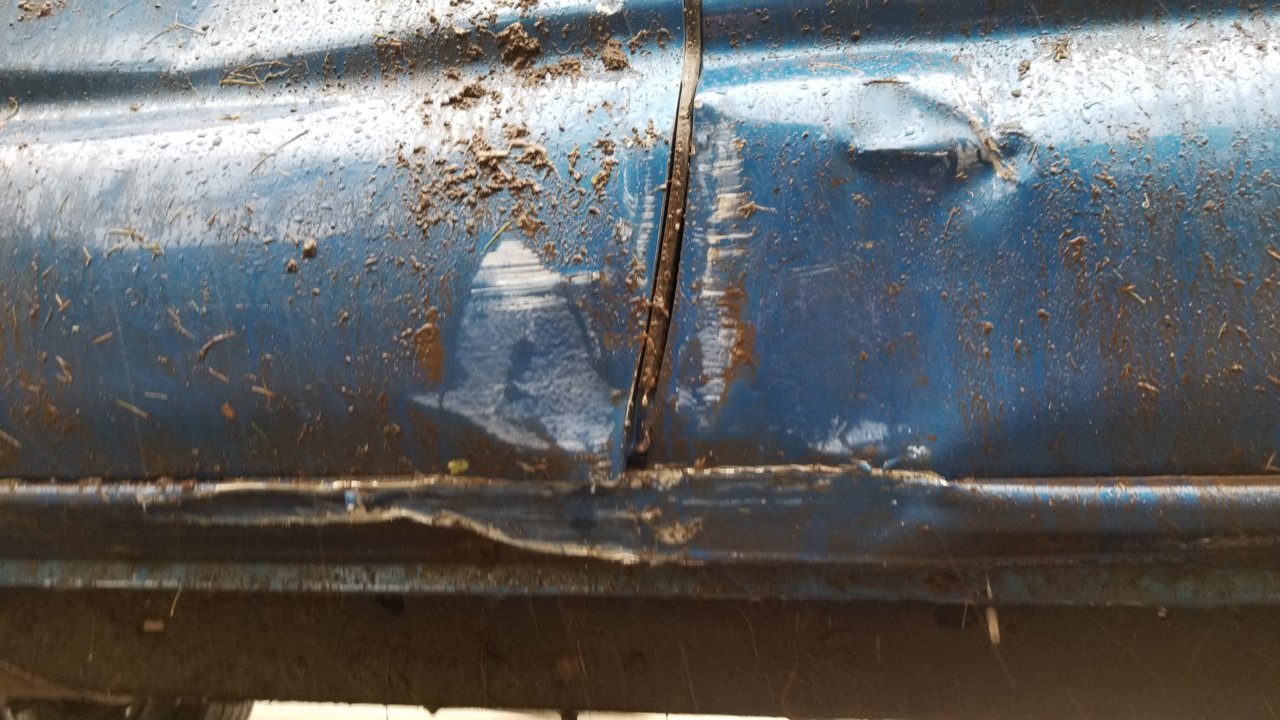

    I think the one thing that might push it towards a total is the damage to the roof.

    Looks like they can just tap it out from under the liner? IDK im not a body shop tech. :notsure:

    It could be and I agree with you on that. I don’t know what the threshold is on roof damage though as it’s a structural support. What do I know though, they replaced the back 1/4 of my frame and didn’t total it out.

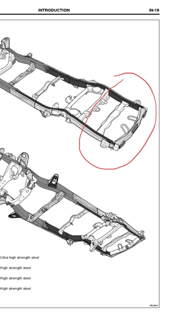

    This is what was cut out and replaced on my 4R

    Idk who did that, but it’s a huge no-no
    You’ve got the illustration from the TIS so you can see that’s UHSS

    Toyota did it and authorized the repair. As long as the welds didn’t exceed a set temperature for specific period of time. Trust me, I had a shit ton of concern over it all but was assured that it’s normal and that the tech who was completing the repairs was certified by Toyota to conduct the welding and repair to the frame.

    Not saying you are wrong by any means...but I’m master certified by Toyota, and have been to all of the collision training, and nowhere would they ever endorse sectioning a frame, let alone one that is 980mpa
    They don’t even sell a replacement for the “back 1/4 of the frame” which means it would have had to come off a used frame, and they would never endorse that either.
    They will allow you to replace the very rear crossmember however, so I’m hoping your just mistaken about what they actually did to it...
