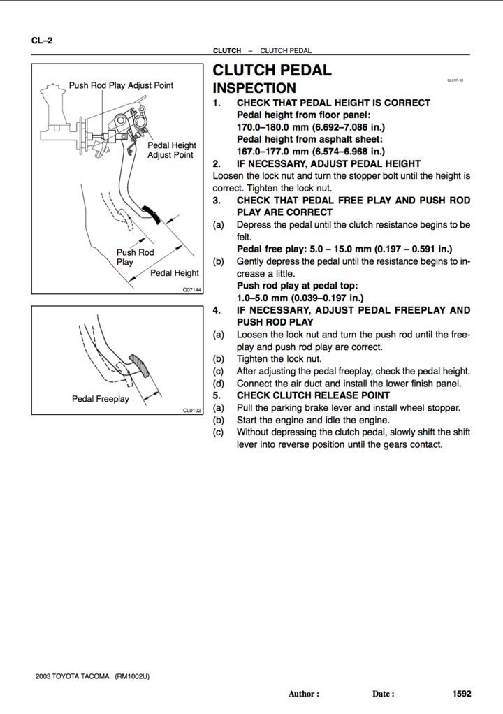

    Have you made sure there is 5-15mm of free play in the pedal before it starts engaging the pushrod on the clutch master cylinder? this is where i'd start. Clutch is the same between prerunner and 4wd

    Here are some details on the pedal adjustment procedure from the factory service manual

    Dirty fluid in clutch master cylinder can cause this.

    When I did a clutch job, mine would not dis-engage with the pedal to the floor.
    had to adjust the free play, push rod AND the fluid at the slave cylinder was N A S T Y!!!
    took a few drives adjusting the rod but I got it where I wanted it.
