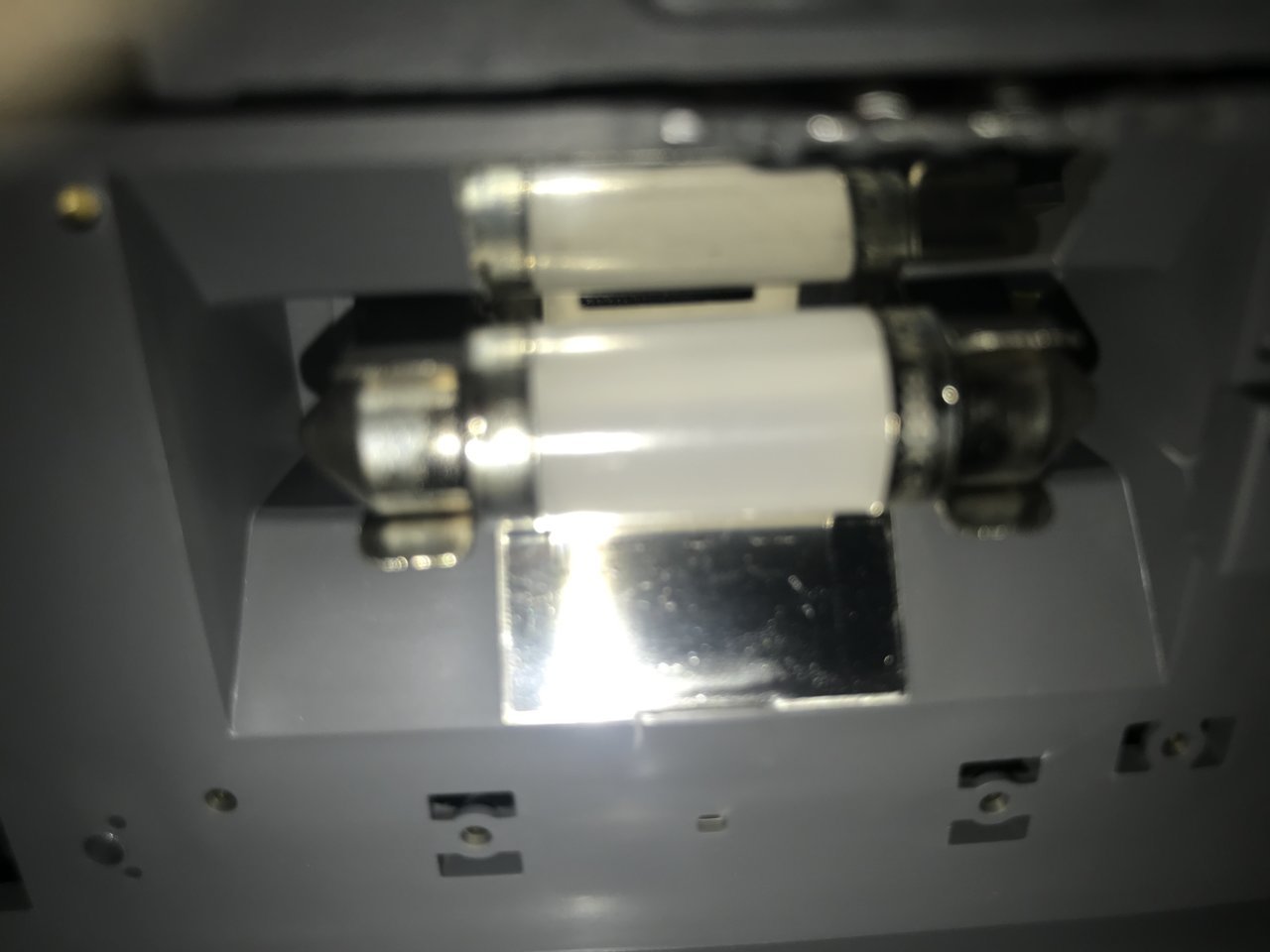

    Mystery solved! I hooked the new LED bulb to a power supply and it worked. What?? Then I checked the voltage in the dome and it is correct. Then I put the bulb in (didn't work) and was checking voltage and as soon as my probe touched the end of the bulb and the dome light contact, the light came on. So there was no contact between the dome light and the bulb, on one side.
    The Sylvania bulb has different dimensions than OEM. The contacts are further apart. It is really easy to see side-by-side. So the middle glass part (where the LEDs are) is larger diamater than the metal contact, and that was pushing out the clamp(?) that holds one contact on the bulb. All I had to do was wrap some wire around the bulb contact, shove it into place, and now the wire is forcing contact and it all works.
    You can see here how the white part pushes apart the contact. And no, I couldn't get it to wiggle side to side and touch on both sides. I could never get both sides to make contact at the same time. But the little bit of wire did the trick.

    The white part shouldn’t even be inside the contacts, on my truck the bulb fits correctly. That could be a manufacturing defect. At least it’s working.

    You mean a defect in the bulb? Or my dome light contacts are pushed in towards each other, causing them to touch the white part? I should have taken a picture of the bulbs side-by-side, it is real obvious the dimensions are different.
