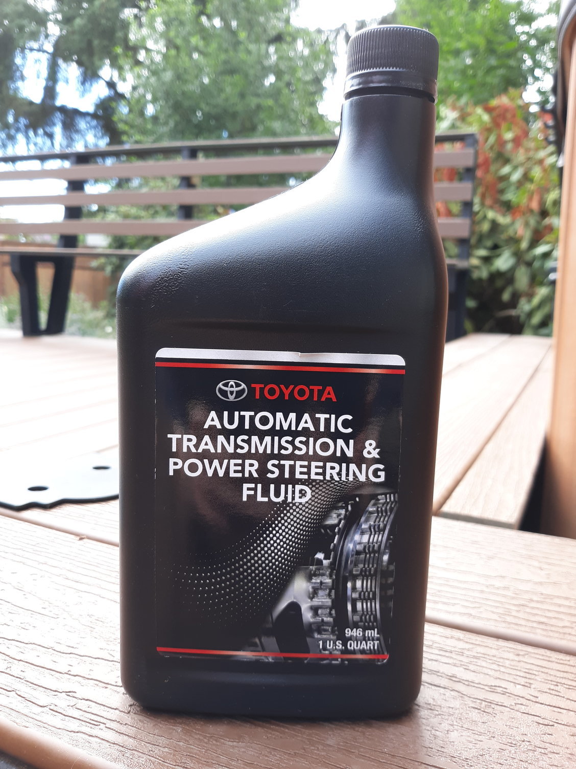

    My local dealer recommended Johnsen's too. I went with 3 quarts of this...
    Valvoline works just fine too.
