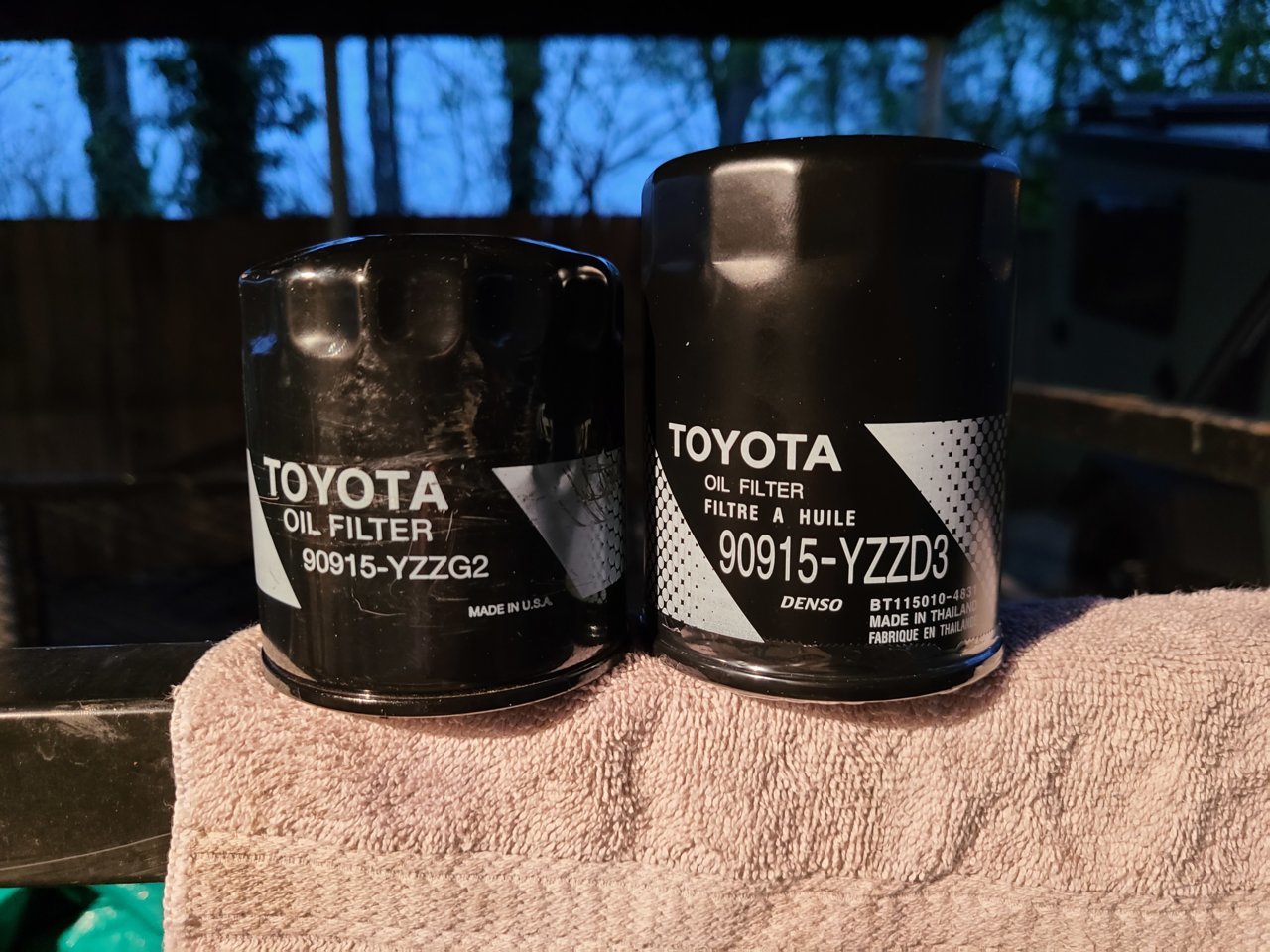

    I had to go back to Toyota today because I was given the wrong oil/air/cabin air filters for my year model(I didn't check the bag before I left).
    I notice the new filters were skinnier and longer than I've been using and after research it seems the filters they have been giving me were for the 2.7. I've been running these short ones atleast since I bought the truck a year and a half ago.. i always specify I have a 4.0 and they should be asking anyway.
    So is there any chance I'm gonna have engine issues because of this?

    You're fine. I run them both on my truck. It all depends on what I have on hand at the time of my oil change.
    All it is is a longer filter.

    If you were going to have issues, you probably would have had them by now.
    I’d just continue using the correct filter and keep driving.
    Most (all) filters have a by-pass. If oil is restricted enough by the filter media, the by-pass opens to allow oil to continue to flow through the filter. Although it’s unfiltered, it’s better than no oil flow.
    I really think you are fine.
    It going to be OK:thumbsup:

    You have the 2.7? If so the bigger filter is an upgrade for you. In my case a downgrade.
    I know the dealer isn't gonna admit fault or do a compression test and valve train examination to see if they caused damage from lack of oil flow or not filtered oil. It is what it is now.

    What’s the big deal here? It’s only gonna require you to fill the oil pan a tad more since the filter holds more oil.

    The short filter is what comes from the factory. I just ask for D3 oil filters when I get them.

    You're fine. There's probably 3 extra ounces of oil capacity in the larger filter and 10-15% more media. This certainly didn't cause any damage, and don't consider looking for any by doing compression tests, etc.

    If you're wrenching on the vehicle yourself its your responsibility to make sure the correct parts are being used. Hold the filters up side by side and make sure they match before installing next time.
    You're lucky its just some paper filters and an oil filter (with the same threads) that got mixed up. Other more critical parts could actually cause damage if installed incorrectly.

    Short filter, tall filter... use them both, couldn’t care less and coming up on 180k with 7,500mi oci’s. Zero oil loss between changes (that I can see) and considering 10k- just depends on what Blackstone says.
