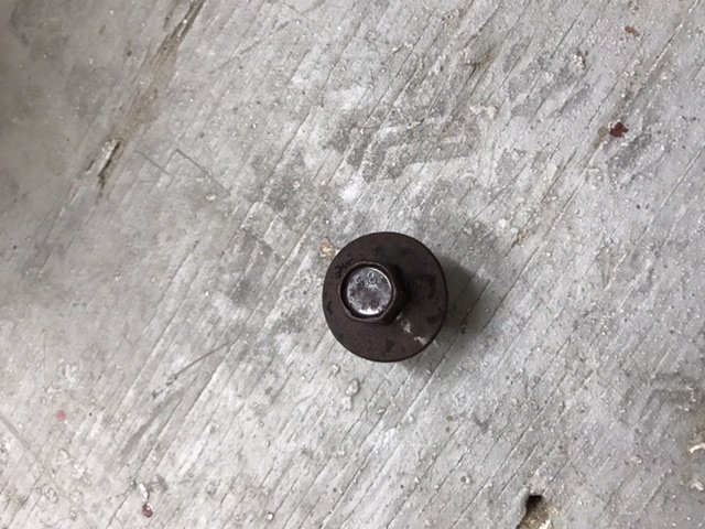

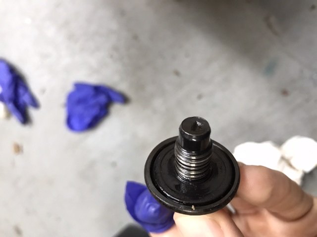

    Changing the oil today; last change was about two years ago (~3k miles) by a shop that changed the alternator (I recall reluctantly agreeing to let them change the oil at the same time).
    Oil pan plug was a bit awkward to remove today, very tight at first and then couldn’t really undo it by hand.
    I was then shocked to see that the threads are completely worn...it almost looks as if they used the wrong plug and forced it closed. See pics. It was a size 14. Does this look like the correct plug?
    Question is what the hell to do now. Just buy a new plug and hope it holds? Try to re-thread the oil pan?
    Has this happened to anyone before?
    this thread will be forwarded to my wife about why I NEVER WANT ANYONE ELSE EVER WORKING ON MY CARS!

    That's a GM drain plug haha. I'd try buying the correct one, tap out the threads with the right pitch and see if it holds.

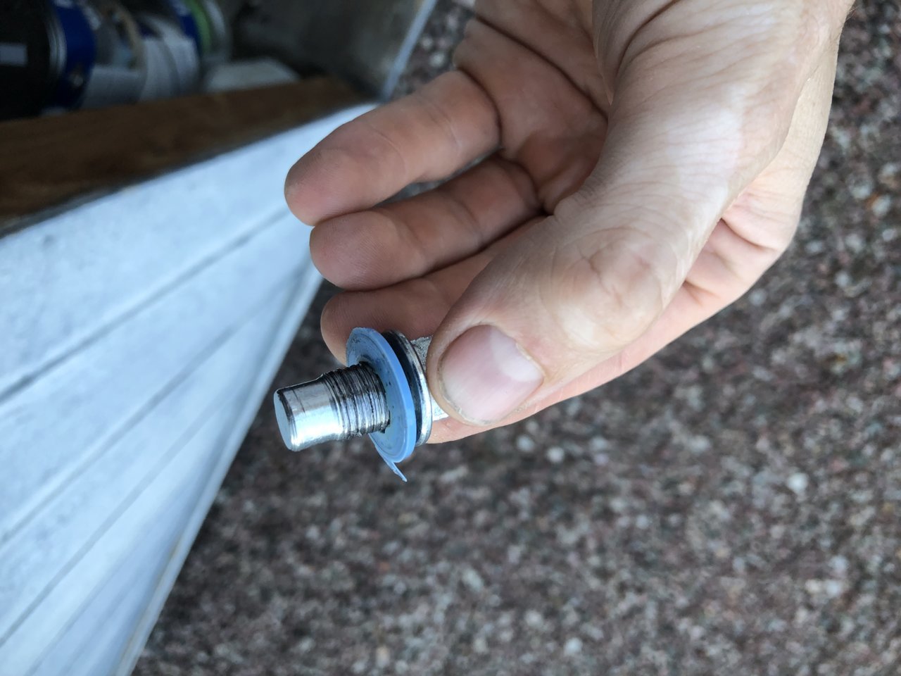

    Thanks for all the fast replays. This is further reinforcement of why I always want to do my own work.

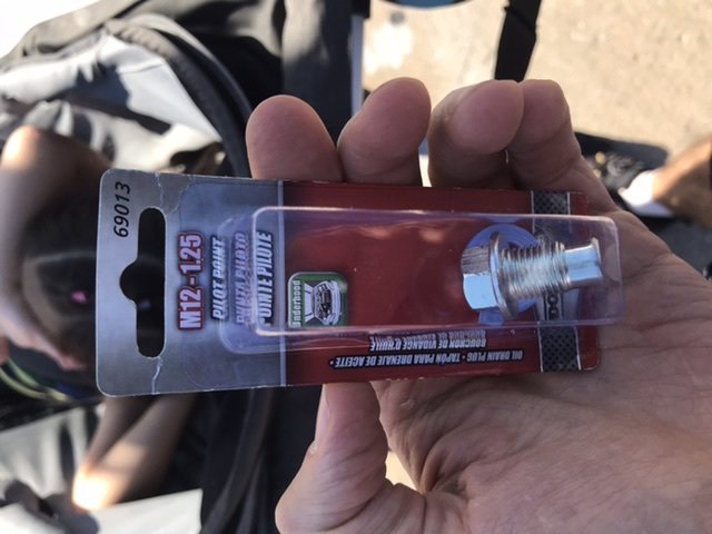

    I bought the only replacement they had at the nearby pep boys. See pic. will try to gently install it to see if the oil pan threads are f’d.

    you might want to get a tap and chase those threads before trying to thread the bolt in there.

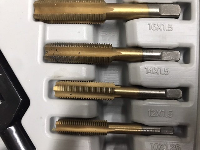

    indeed, I gently tried installing the bolt and met a bunch of resistance. And of course my tap set skips over M12x1.25.
    I’ve ordered the correct tap size and will wait to install the bolt until I have it. Any other suggestions?

    The tap finally got delivered (it took 5 days rather than next day), and I used it to clean out the threads. It was a real pain. I removed the skid plates and then had to use quite a bit of force with the tap to re-thread the pan. Access was limited by the transmission right beside the oil pan. I etched out a good amount of metal shards. The new bolt wasn't as easy to screw on as I would expect but I did get it installed without excessively high torque.

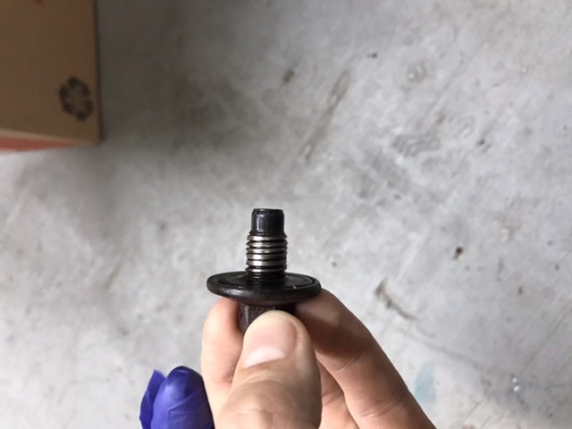

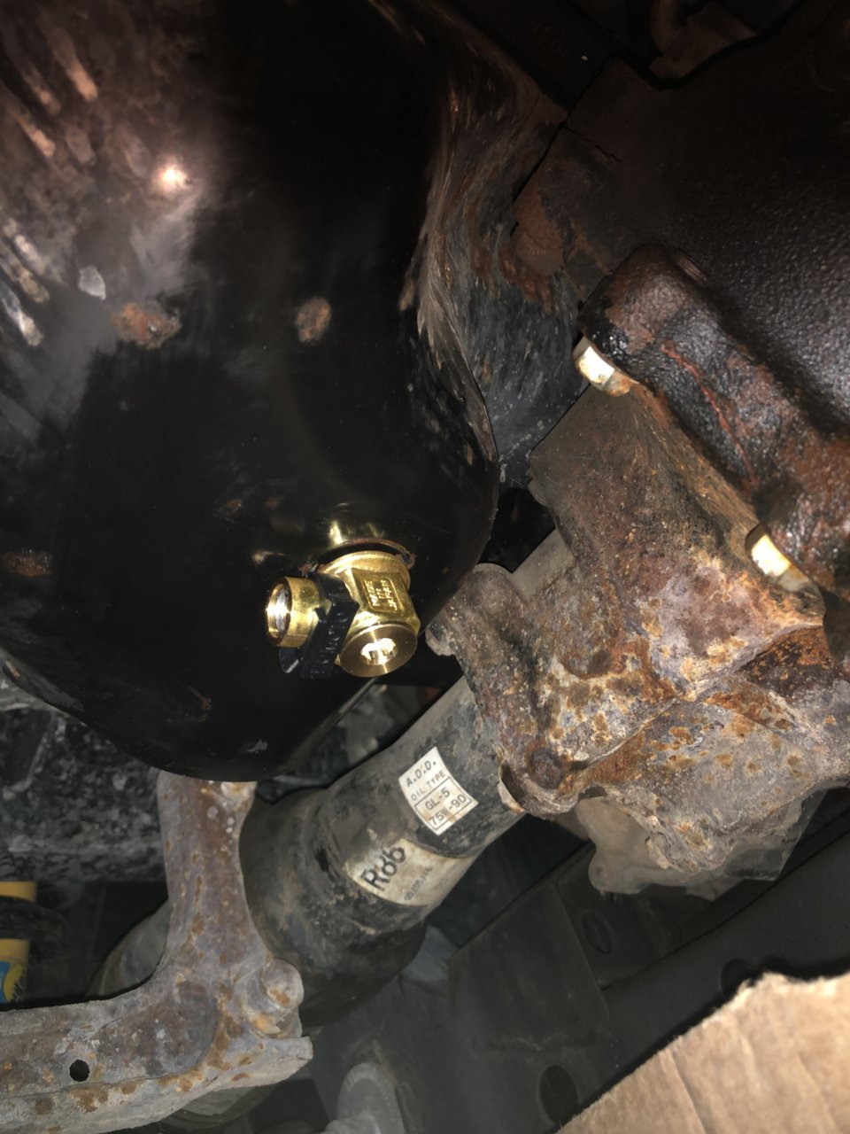

    Looping back to an old post of mine.
    I finally got around to the next oil change since above debacle. I removed the bolt from 2 years ago with some resistance, and it’s threads were totally f’d:

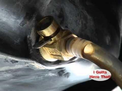

    I tried installing a new bolt, but it leaked pretty badly, about a tenth of a quart a day. So I removed the skid plates, re-tapped with the same tap, cleaned it out with a snake magnet, and installed the Fumoto valve:
    Hoping it holds…if not, any thoughts on using a slightly larger size tap and bolt?

    Holy fucking rust.
    Your frame could certainly benefit from an oil leak.

    That’s not the frame. The frame was replaced five years ago under the extended warranty program.
