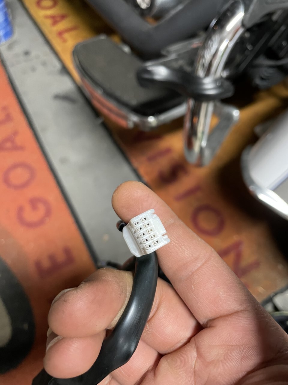

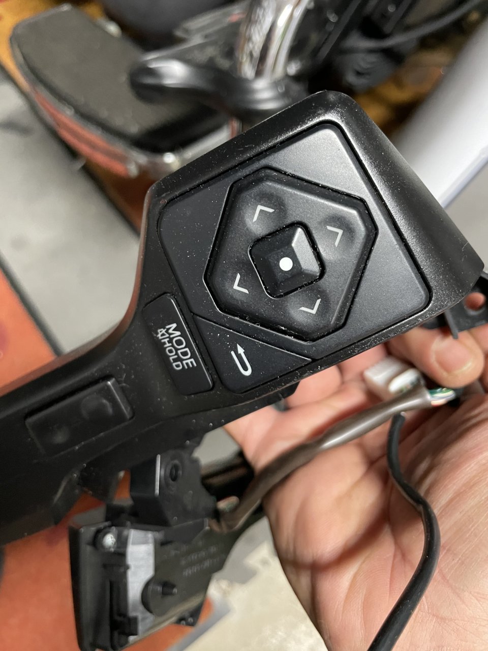

    Hi all! So I decided to add the radio steering wheel controls to my truck I changed the airbag cover and then the clock spring. I ordered the controls from china. Here is my problem... The controls for the radio do not match the clock spring I installed. The radio controls have 6 pins across while the clock spring has 5 across. Which one is wrong!? Lolol. Thanks for helping as always!

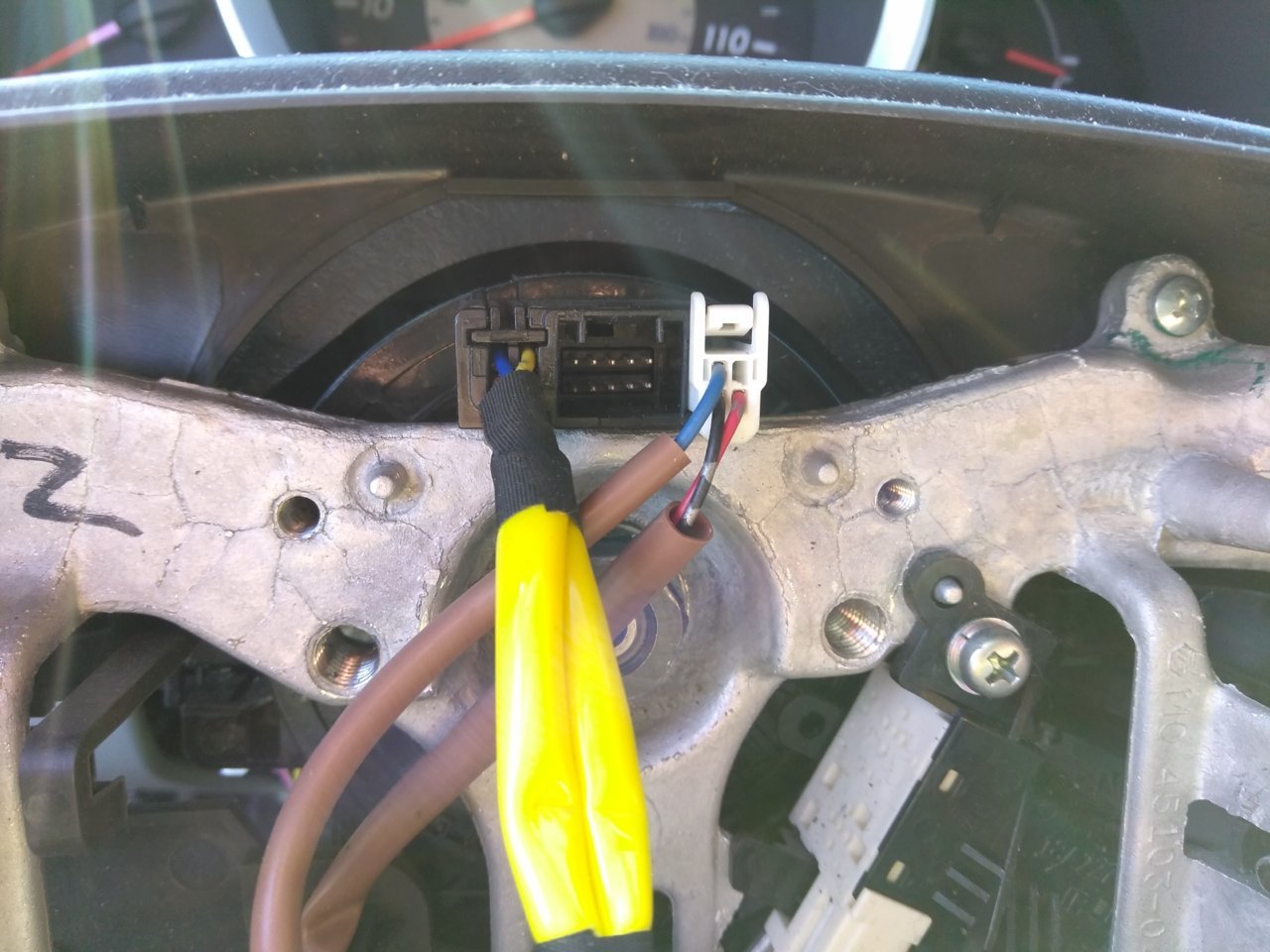

    Does the plug from steering wheel controls fit the clock spring, if it fits it will work. I did mine last week, never had swc before. Check out my posts.

    no plug wont fit.. it 1 pin too wide! the clock spring has 5 pins lengthwise while the SWC plug are 6 pins wide... i will check out your post! thanks!

    I bought everything from eBay, everything thing works on mine, never had swc on my 07 Tacoma

    It’s the controls, the clock spring is 5 pins...I did the Corolla wheel on my 07 with no controls

    Thank you! i am ordering a new left hand side SWC which should have the 5pin... THANKS AGAIN!

    yeah, that’s the same plug that goes into the clockspring...I had to get the newer controls cause the other end that plugs into the controls are the same ones on the Corolla wheel.
