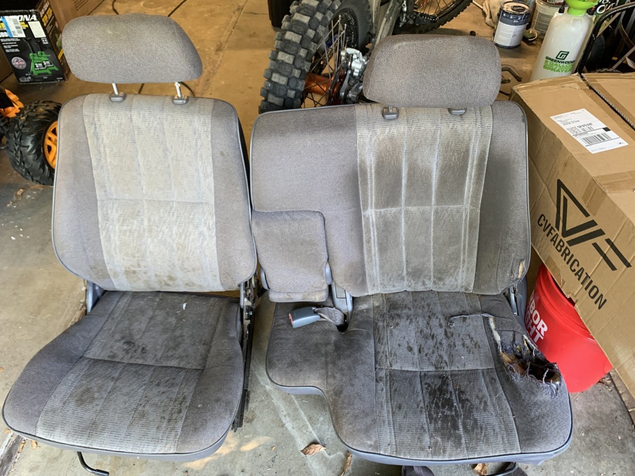

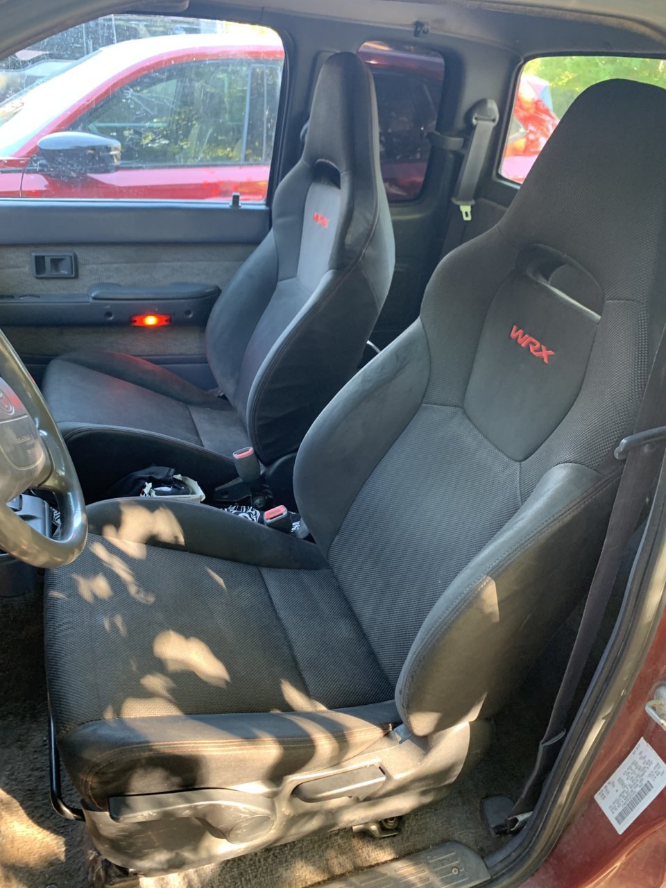

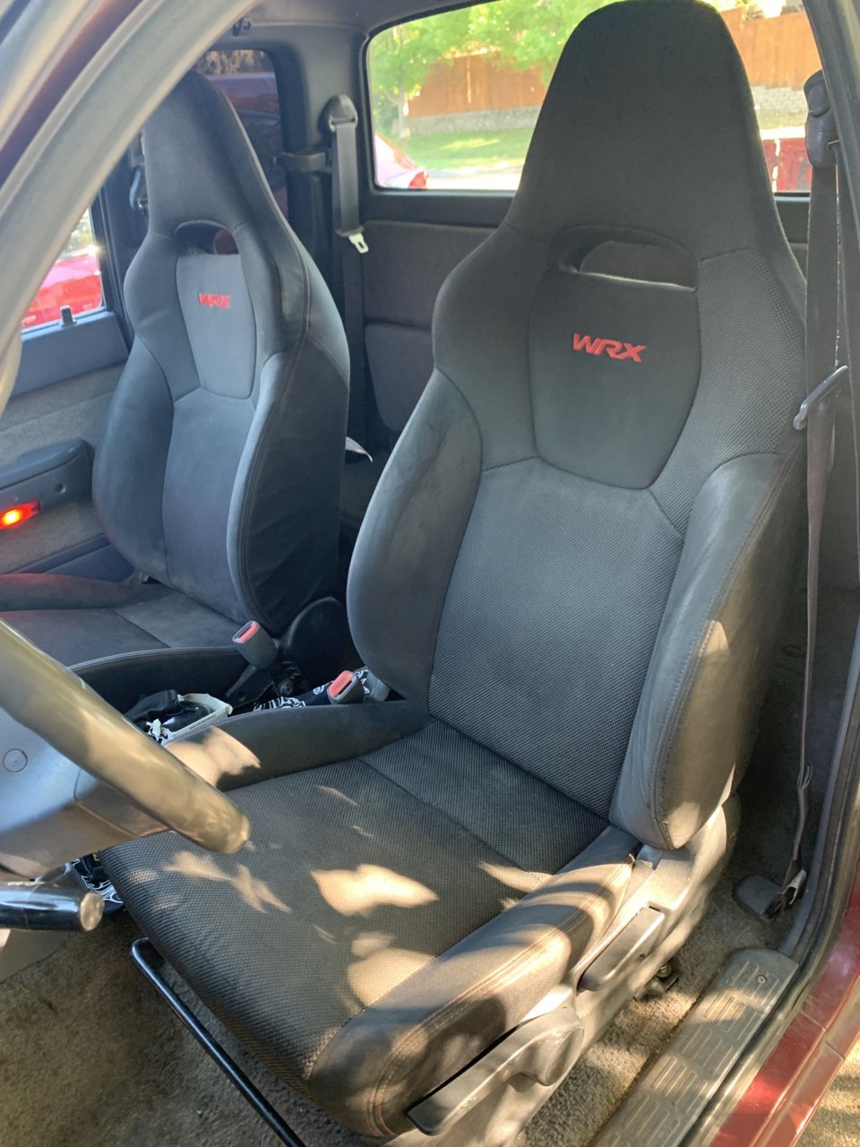

    So my 60/40 bench was disgusting, bought the truck Memorial Day weekend this year and the truck was rode hard and put away wet by the previous owner. Anyways the seats were disgusting and missing foam and broke down. So I knew I wanted something better and prefably bucket seats. I couldn’t find anything locally in great shape for a decent price. So I walked the junkyard in hopes of finding a donor taco or 4Runner. No luck. I did stumble across a 2009 Subaru wrx and it had some nice seats in it, after a quick google search I found it to be possible. So pulled the seats and stole them for $175. They are heated as well, I’ll be wiring that up once I find a center console. Wondering if a 4Runner center console will fit.

    Were they a direct bolt in?

    Pretty close, 2 of the 4 holes line up, one you have to bend the tab down and notch it to catch the factory hole and only had to drill one new hole on the trans tunnel.
