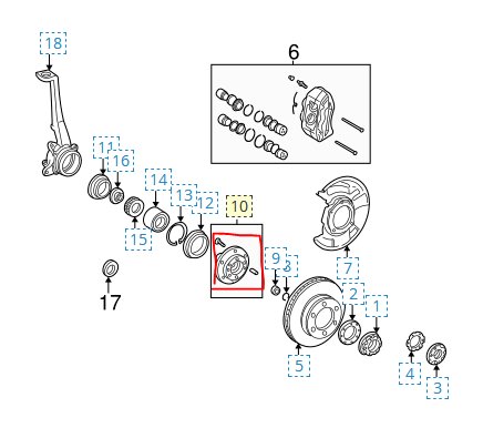

    This is the last part I need for my 4x4 conversion. The spindle must still have the manual hub assembly marked in red(43502-35160) but I don't need manual locking hubs. If someone could source me that part alone for both sides that would be great too.
    Thanks

    Durago brand is what RockAuto appears to have for manual hub trucks. I'd like to use as few non-oem parts as possible but I can't imagine this would be a problem vs Toyota OEM.

    Grabbed the hub assembly alone 43502-35160 from rock auto. Hopefully I won't regret grabbing one non OEM part down the road.
