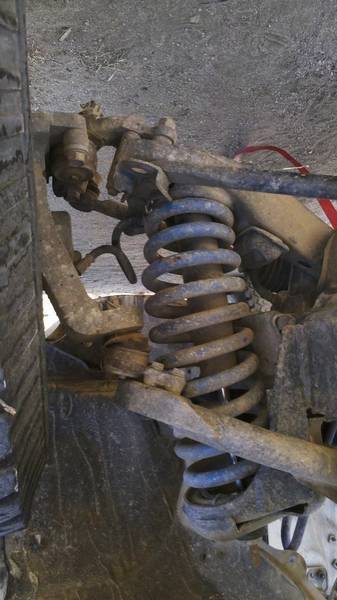

    should look like this

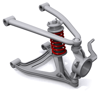

    Coilover suspension. This is what you have.
    Strut suspension. This is what you don't have.

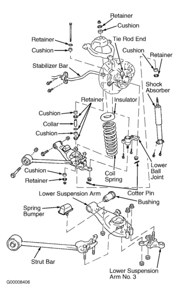

    Well, upon further investigation it looks like he has coil springs and front shocks. Got this from Mitchell-on-Demand, using 99 Tacoma 2wd (non-prerunner). Now he's gonna be more confused.

    This shows what my diagram can't. It has a coil spring with a regular shock running through the middle. not coilover or strut.
    Well OP from what I can see you can't use springs from a prerunner because they will be smaller in diameter and longer in length.
