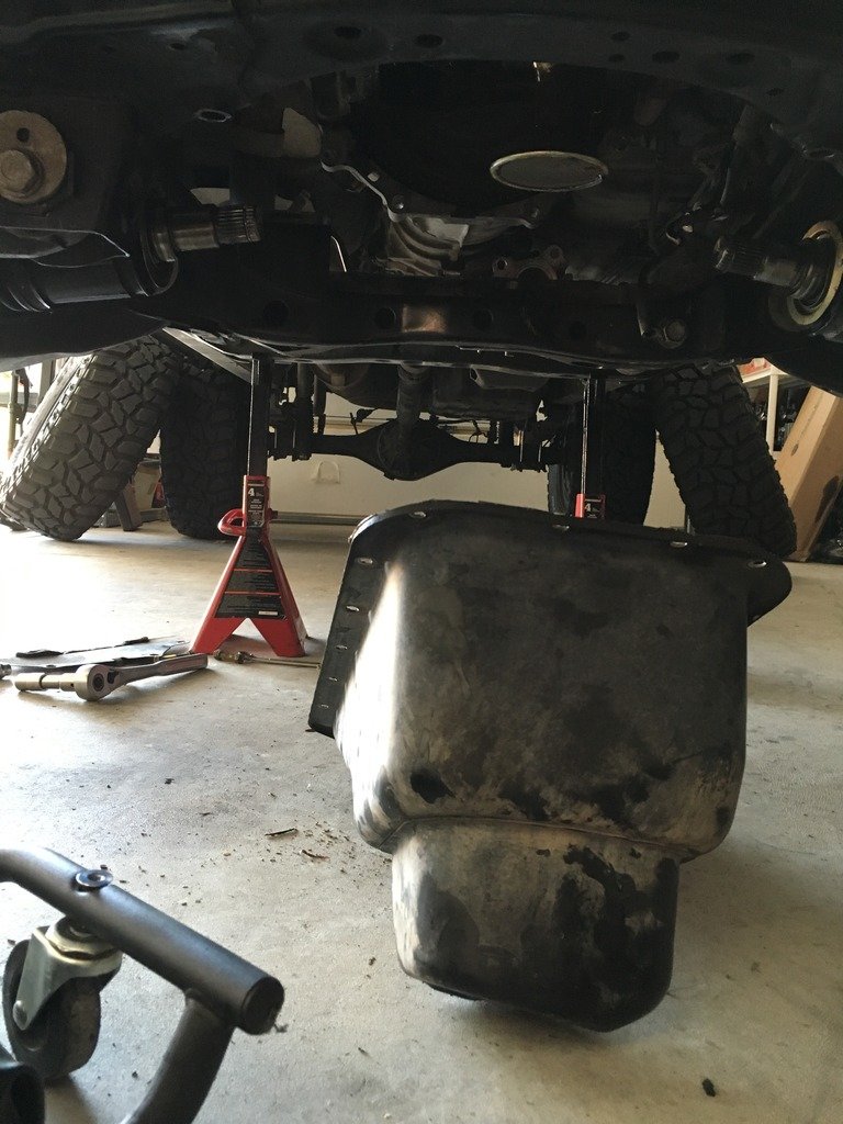

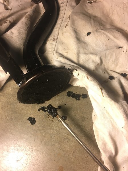

    on my last thread about oil dummy light comes on during idle on my 99 prerunner 2.7 3rz motor i replace the sender bc Autozone was out of manual pressure tester.light was gone for a day then comes back again during idle 800-1000 rpm

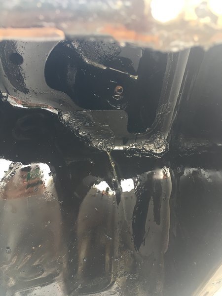

    So i went under and remove the oil pan and found the pick up oil tube completely blocked with this black charcoal thing idk whats that
    Does anybody know what is this?
    Also im thinking to replace the tube instead of cleaning it
    Also the whole tube covered by black film i can scrape it away but thinking about just change the whole tube

    How often do you change your oil, because that black material looks like sludge and you may want to clean out the sludge before replacing the oil port.
    Does anyone else think his engine looks covered in sludge?

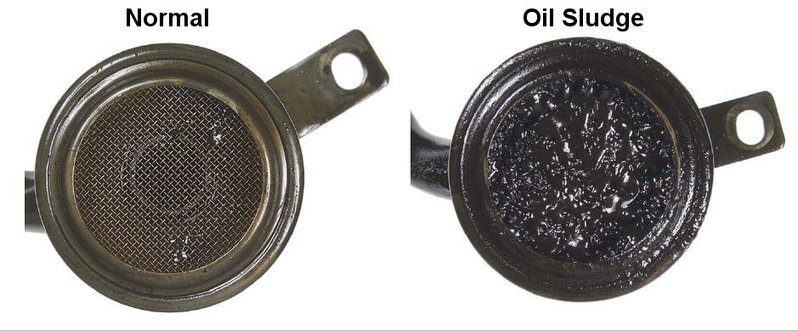

    This photo looks like yours here =>

    Yep, Sludge. I have also herd of different types of oil doing this, even if you change your oil on a regular basis. Usually cheep motor oil.

    Frankly, it just looks like neglect. But a picture on the internet is not always easy to diagnose.
    Drop some of the particulate off the pickup in a container with a little mineral spirits in it. If it's sludge, it should dissolve with a bit if agitation.
