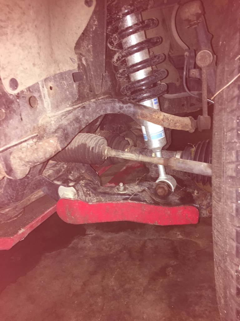

    IMG_1373.jpg This is a healthy sway bar picture

  15. Jun 27, 2017 at 6:20 PM
    Northern Taco
    Northern Taco [OP] Well-Known Member
    Oct 8, 2015
    #166156
    2,816
    2022 Tacoma trd off road premium 2023 tundra trd off road
    Bent that rusted POS out of the way last Thursday when I did the sway bar end links. I'm going to torque the lca bolts to 100 ft/lbs and cross my fingers.
