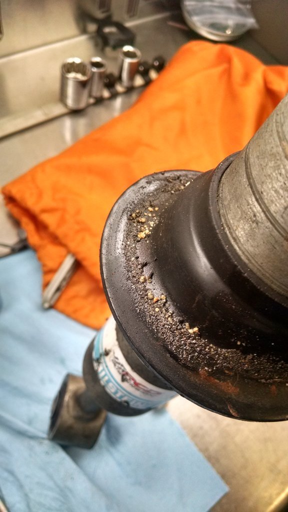

    I had a deep creak/squeak that was driving me nuts. Replaced LCA's, front body mounts, soaked pb blaster in cab spot welds, cleaned and anti seized shock hardware. Still squeaked. Got new struts all around. Went to pull my old ones and found this. I'm willing to bet my creak/squeak was this dirt/grit being pulverized between the bottom of my coil and the metal spring seat on the strut. I had powerwashed it but clearly not well enough!

    I was thinking about this too. I hit mine with pressure washer as well then sprayed penetrating oil on that area. I may have to disassemble the coils and clean them as well. I'll have to wait to do that as I don't have a spring compressor

    I powerwashed and soaked them in penetrating oil. Very easy to disassemble could on truck, there's a video on here if you search. I was surprised how much grit was still caught in there. I'm thinking I might add some foam around there to prevent stuff from getting in.
    1. Block rear wheels
    2. Break Lugnuts loose
    3. Remove wheel and place jackstand under frame
    4. Place jack under lower control arm knuckle. I jack it up a half inch to an inch so spring is compressed slightly.
    5. Remove two 19mm bolts attaching the lower control arm knuckle.
    6. Remove top strut center nut.
    7. Use jack so slowly lower control arm until no more tension on coil.
    8. Take your time and you'll have zero issues. I swapped front struts this way in about an hour. I've done it 5 times or so now. Much quicker than spring compressors.

    I can't say for certain as I replaced the struts all together. That being said, my old ones were not blown or leaking, indicating they were indeed functioning normally. When I finished side one and took it around the block my squeak/creak got significantly reduced. Finished side 2 and completely gone. It's free and relatively quick to check / eliminate. I will be checking this area first if it returns.
