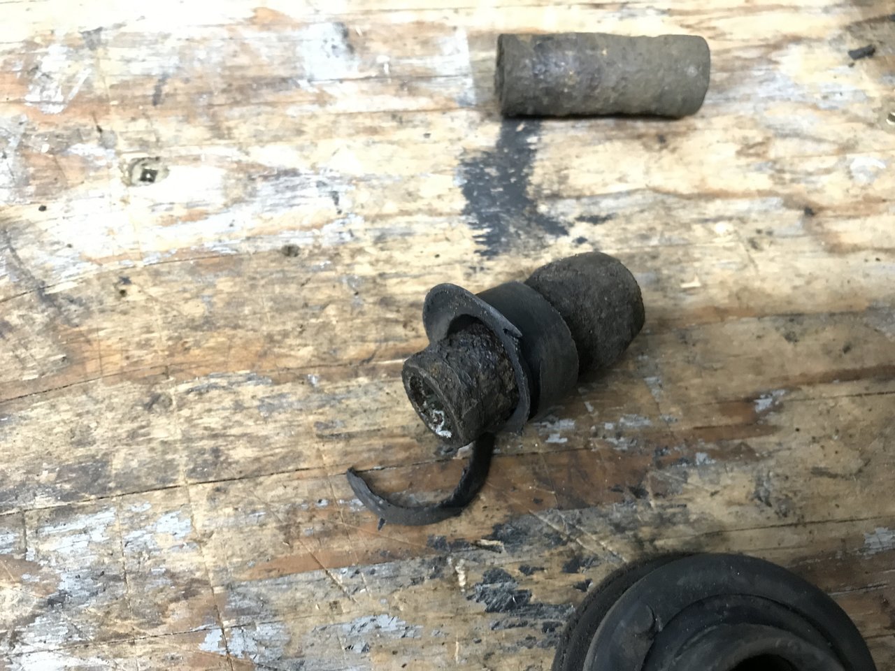

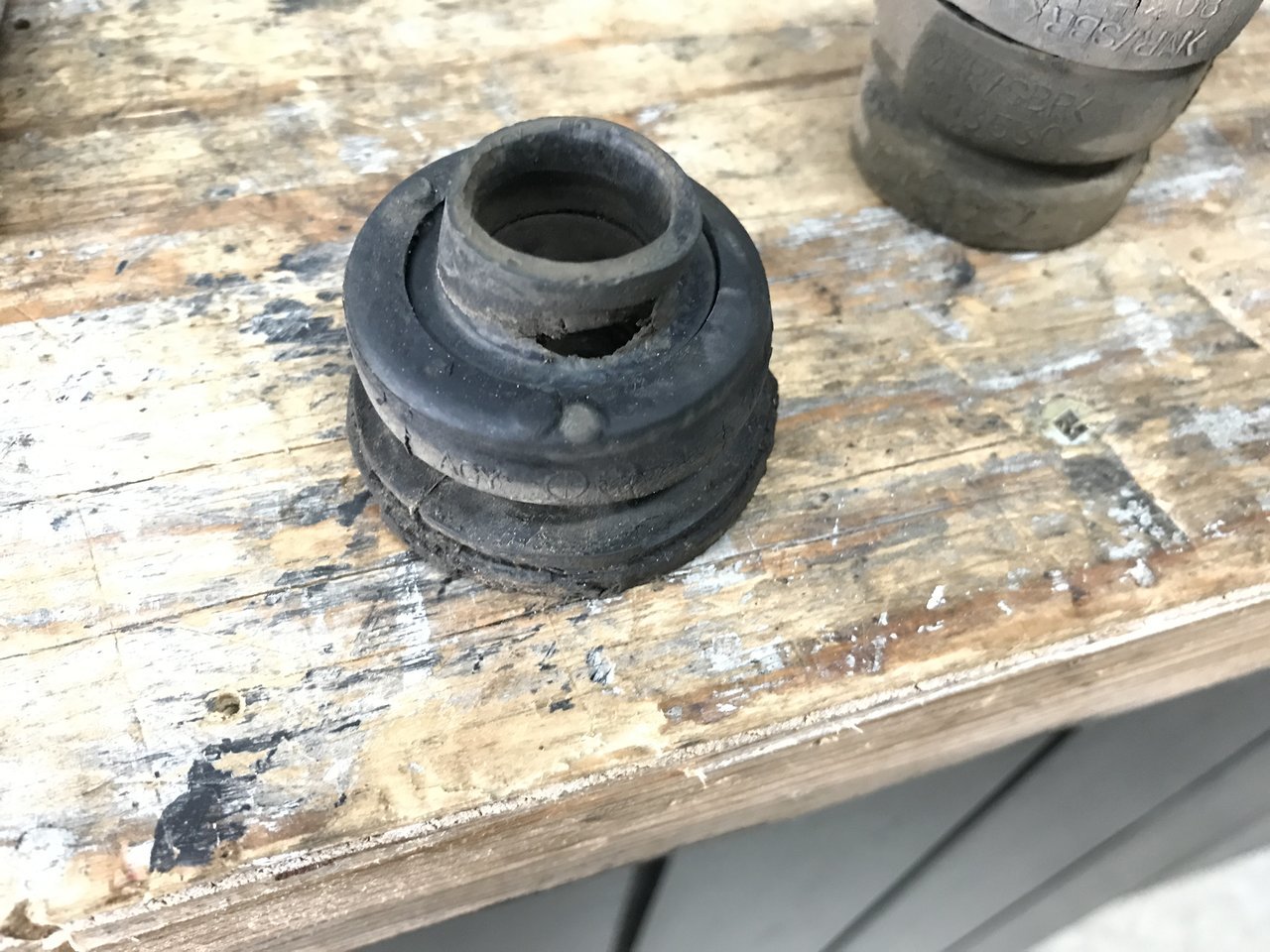

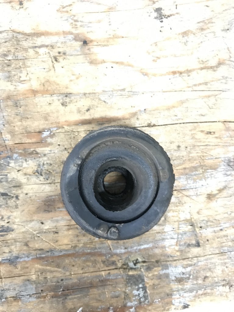

    Just an update,i replaced my radiator core mounts with energy suspension poly mounts. The creaking is all but gone now, I only hear it on larger hits off-road at work. My mounts were shot, and I think the new ones, being stiffer, are keeping the bumper mounts from flexing as much thus keeping the creaking to a minimum.
    Here is what my original rubber mounts looked like
