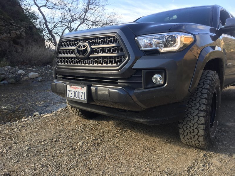

    What the hell is this piece of plastic that makes my truck look like it has a double chin and why do I not see it on other 16's? Is it bad to take off?

    That is an air dam. It's supposed to improve aerodynamics, thus improving MPG. It's easily removable and installable. I think the Sports have it and ORs don't, for reason of increased approach angle without it.

    You can remove it. Mpg may drop as much as 1mpg and you'll get extra wind noise. I got rid of mine, don't care about the 2 cons.

    Aerodynamics. Take it off. Or dont.

    I'm taking it off. It makes my truck look like it has a neck beard.

    Aero bro, aero. Look at the NASCAR frontal areas. Basically the same idea. Having worked in windtunnels in Canadia (where 0210 is from), these things have to be really close to the ground to have good effect. With the KoBro tires, you've already cancelled out the benefits to some degree. Just yank it.
