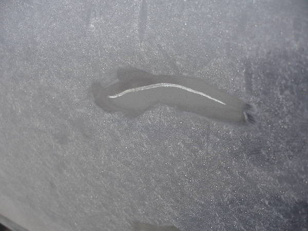

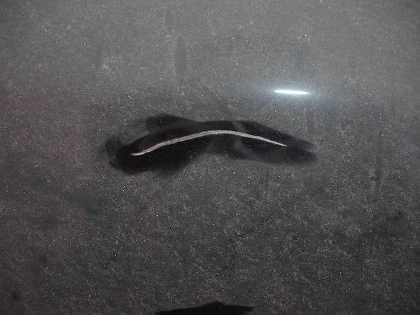

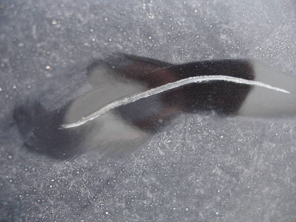

    It has happened.....
    Yes, I just collected a new f...ing scratch/ding, me and the wife were shopping groceries, came out, got into the truck didn't noticed anything until we arrived home, obviously the a-hole who did it didnt left a name, note or even a "yes, I fucked up your truck hahaha" Im so pissed....
    I dont think the scratch went more than the clear coat, but there is a ding, dong, dung, dang or whatever, i might buff it out but I think my nail catches it.... if i take it to a repair center, the a-holes will want to paint my whole door with unmatched paint, opinions???
    **pictures uploading**
    rear door

    wel if your finger nail catches it...its not gonna buff out completley...find some 2000 grit sandpaper and wet sand the spot lightly (not too much) try to just sand enough to make it even then take and buff it out with some buffing compoutn the finish it up with polishing compound...then wax...see what that will do for you. If that doesnt work use touch up paint to fill in the scratch until its higher then the paint above it...then wet sand with 2000 grit until even with factory paint and then buff...i honestly would just do the touch up route to begin with...

    Dealership quoted me around $90, they would paint lower half of the door, still dont know, Ford's body shop has a PDR guy, they wont open until 3pm, so im looking at two possible solutions
    1. PDR the dent, then add some touch-up paint which im estimating for around $130 or
    2. Paint the lower half of the door for $90
    both options are riskie
