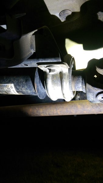

    Maybe I found a problem. Standby...

    That carrier bearing (I think that's what it is) has quite a bit of play. Is that normal?

    That ain't normal. Again, look good and hard at the u-joints and think about them as you replace the center bearing! Congrats and good luck!

    You can see the drive shaft actually sits a little low in there. I pushed on it and it actually looks ripped inside
